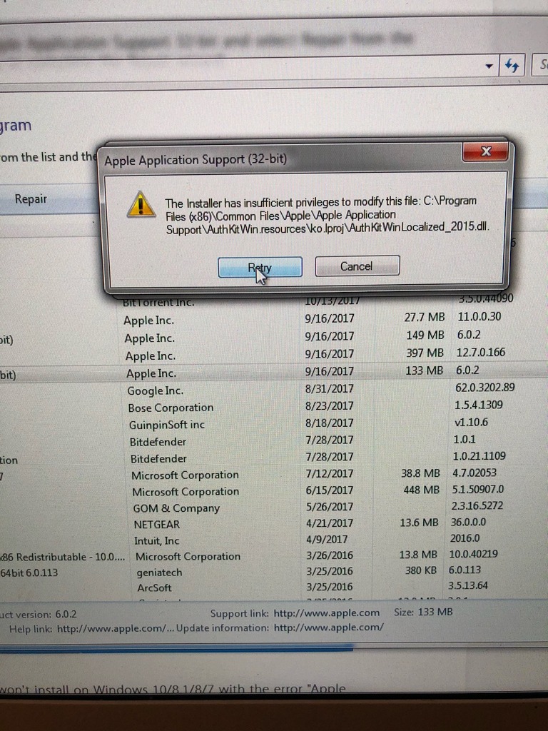

Had my computer for over a year. I would say last winter whenever I got an Itunes update I would get an "itunes invalid signature" so I would have to update manually. Fast forward to this past week. New Itunes update. When I tried to install manually I got a new error pictured below.
I tired to run as administrator, didn't work. I went into internet options to allow invalid signatures to install but that didn't work either. I really have no idea what to do. Any help would be greatly appreciated.
Also like to add that I'm on windows 7 however when I right click on itunes under compatibility is says windows vista. Changed it to windows 7 and things ran extremely slow. So I switched it back to windows vista.

In 2015 I did get a new PC. My friend built it for me. Both my laptop and new computer are running windows 7. Downloaded Itunes as new on new computer first then transferred the files over from old computer to the new one. Again this all happened in 2015 so why am I all of the sudden having issues now is beyond me. Speaking of which, if you look at the photo I posted, in the error is has the date 2015 in it.

Your picture shows a file from a Korean language folder, so maybe 2015 was the last year that Korean language folder was updated by Microsoft (I don't know, just guessing), or was created as part of the first Windows install on your new PC (which you say was done in 2015). Your screen shot is not displaying a date - only a year, which again, may simply be year that was first installed on your PC.

I hit repair on the apple update, repaired apple application support 64 bit and when I hit repair on apple application support 32 bit this happened.
