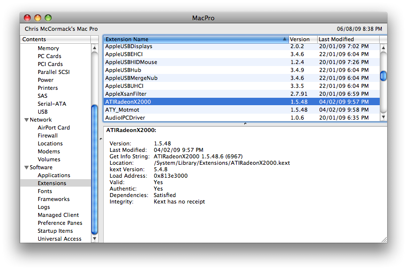

What on earth could be different about my system? What sound output driver are you guys using? Perhaps it has something to do with the combo of video and audio drivers being used? I'm using a USB interface (Lexicon) connected to one of the USB ports on the back of the Mac Pro. 😕
FWIW, this is all I could find in the system info about anything related to an ATI driver... if you want any other info from my system, let me know.
