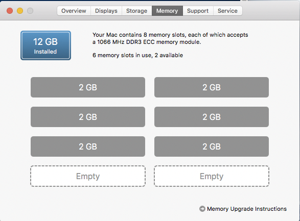

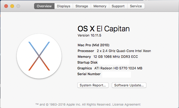

Hello,
Sorry if something like this has already been posted but I couldn't find it in the search. I'm looking for some advice. Long story short, I've been gifted a Mac Pro (Mid 2010). I have been sitting on what to do with it for nine months. Partly because of life commitments and partly because of not knowing what to do with it. At first, I thought I should turn it into a dedicated Plex Server. However, I thought that was a bit overkill and it would be a menial task for something that used to be a beast (still is?). I have now decided to relegate my mid-2010 27" iMac for that task.
My question then is how feasible is it to turn into a gaming computer (and process large amounts of proteomics data when needed). I've always wanted to build a gaming PC/workhorse machine. I feel like I've been given a headstart in that avenue akin to inheriting a muscle car and just restoring some bits here and there. I know if I want to game with it I'd need to go mostly Bootcamp avenue but she runs a few games on Steam alright already: Skylines. So this is what I was thinking of doing:
  • SSD Upgrade x 2
    • Windows 10
    • macOS High Sierra
  • Ram Upgrade
    • 12GB seems too paltry. I'm thinking either 32GB or 64GB
  • GPU Upgrade: Nvidia GTX1080
    • This is one of the main things that have impeded my plans. I know Nvidia released web drivers recently, but I still hear horror stories. Even though the Mac Pro only has a PCI2, that wouldn't be as much of a bottle neck for the GPU, am I right? How would it fair with boot camp. And I don't wish to pay a £200 premium for a flashed one. And with Apple officially supporting eGPUs I think Nvidia will keep supporting OSX in a more timely manner even though both companies have beef
  • Smaller additions: Bluetooth 4.0, USB 3 Upgrade and maybe a Blu-Ray drive for ripping my Blu-Rya collection
I don't think a CPU upgrade would be worth it. I have posted the specs below. Please let me know if my plan is viable or am I better off just scrapping the idea. Could it be done for less than £1k. Considering I got the Mac Pro for free, I think I have a bit of leeway. If I wanted to build a PC from scratch I'd have to factor in motherboard, case, CPU, PSU, etc

Absolutely! My 2c, try to locate a handful of RX580s or RX480s (3) rather than the 1080Ti, and eBay the best processors you can put into it and coin mine (bitcoin / ethereum) your way to profit/breakeven and game on the side. Had I been given one for free that's exactly what I'd do

View attachment 705395 View attachment 705396
CPU upgrade was worth it for me. You can get 2 3.46 ghz x5677 on eBay for ~$100. They are only quad core but you will benefit more from speed than more cores for most games. You don't have to delid for a 5,1 so it is easy.
The 5,1 can do gaming quite well. However, you need to upgrade the CPU. Your Mac is very CPU single thread limiting in gaming. And as the other points out, X5677 is the way to go.
1080 is a nice choice for gaming. Nothing wrong to use that. However, my understanding is a non flashed 1080 can only run PCIe 1.1 in Windows. In MacOS, it can run at PCIe 2.0, however, it won't work at all before Nvidia driver install and activated. This will give you some trouble on every OS update. You better study that, make sure you know what you are doing before you make the purchase.
Anyway, for gaming, only Windows 10 is he way to go. If you don't need MacOS, then you can forget about the web driver trouble.
I believe PCIe 1.1 X16 will bottleneck the card a bit, but won't be very significant. Also, in any case, still able to provide decent gaming experience.
However, £1k may allow you to build a gaming PC that perform better than 5,1. So, you better be sure you want to do this. It's more for fun, or fully utilise the resource, but not for performance. Last but not least, cMP use much more power than a current gen PC. If you put the electricity bill into account, using the 5,1 as gaming machine usually is not a good choice.

For best overall performance definitely upgrade CPU to dual X5675/X5680/X5690. CPU is important, and since 5,1 is quite old you might want to brute force it with max base frequency and max number of cores. Plus with new CPUs RAM will work faster. You should be able to find a couple X5680s for ~$200 on eBay.
For RAM consider 6 DIMMs (3 per CPU). Sweet spot would be 6 x 8GB = 48GB, and it is dirt-cheap anyway. I don't remember exactly, but I think I've got 64GB set of 8GB DIMMs for about $50-70, using only 6 anyway.
For boot drive use PCIe adapter and M.2 blade (Samsung SM951 AHCI for example). This will be around 1500MB/s. Adapter is ~$20 and the blade is ~$170 for 256GB (enough for main disk).
For video 1080 is the way to go, absolutely, if you have the money. Dual AMD 580x might be another option.
Overall I think you can definitely do it for way less than $1000.

* 12 GB of RAM is plenty for games and most general use, actually (except maybe for your proteomics?). Check your "memory pressure" and I think you will see that it's almost always in the "green."
