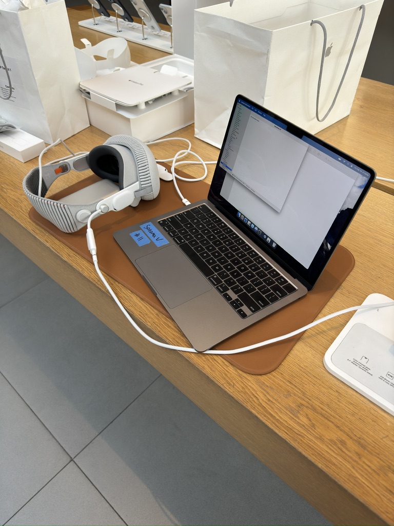

I had a hunch and figured that something had to be up, and went into the store where they did extensive tests on my Vision Pro. They swapped on the developer strap and took a bunch of logs and had me run through required diagnostics with them, and ended up capturing the device for engineering (they were apologetic that they had to do software diagnostics on an issue that was clearly hardware, but it was the protocol for it. They were excited to rev up the diagnostic kit for the first time for sure)

Here's the shot of them about to run dev strap assisted diagnostics for good measure:

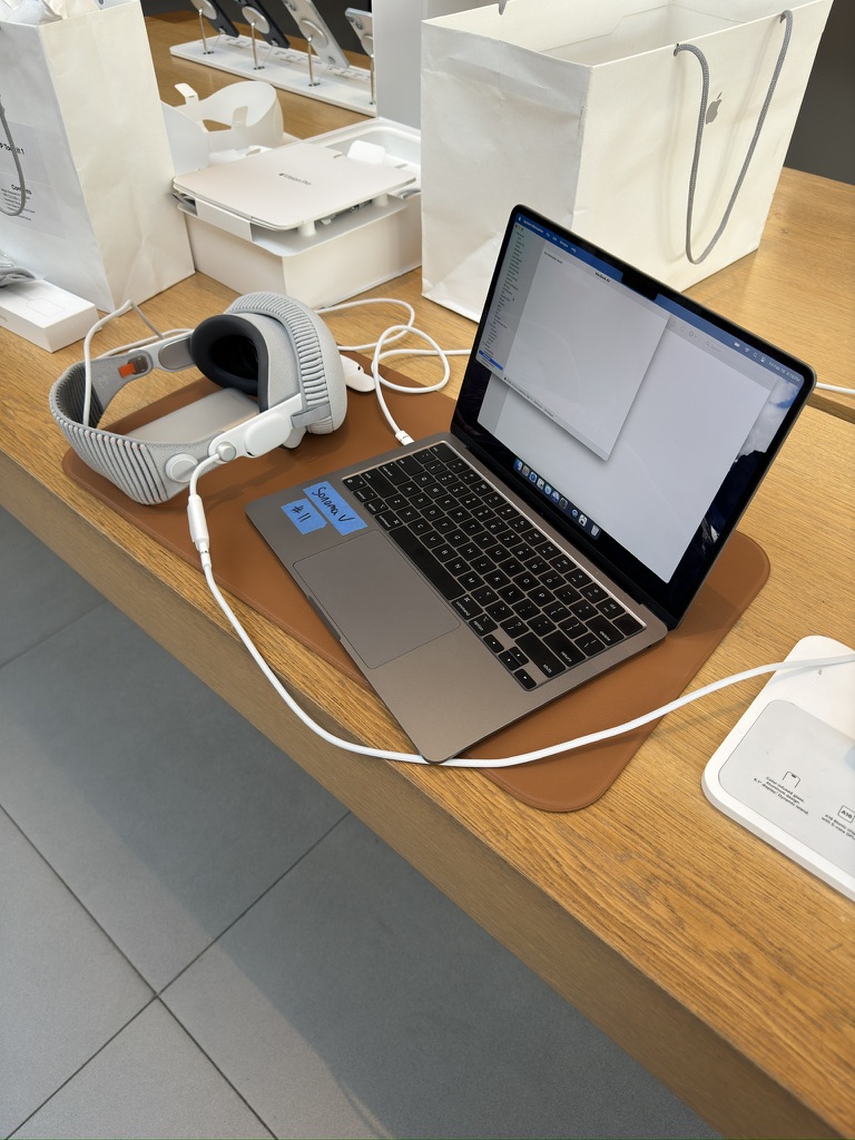

Here's the shot of them about to un dev strap assisted diagnostics for good measure:
