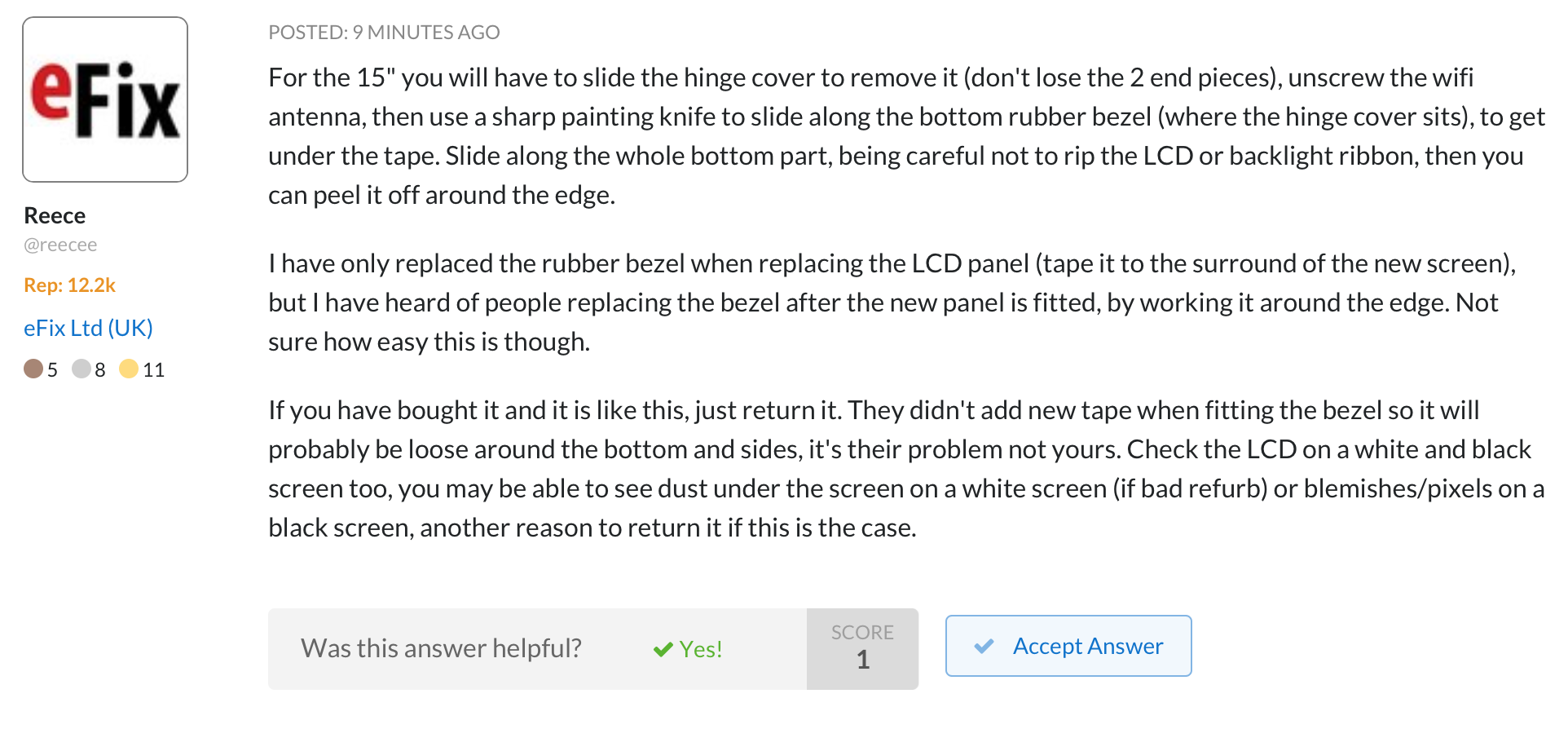

Hello there, I've damaged the rubber bezel that surrounds the display while fitting it back onto the MacBook Pro body.
It was a refurbished unit and I'm pretty sure the seller hadn't stuck the lower part on correctly. The large rubber pad to the lower right of the screen tore upon closing the lid the first time. It flapped around and looked awful after that, so I've torn it off and used some electrical tape for now to hide the gap.
Initially reasonably pleased with this little repair, it's now getting to me every time I open the computer... So I've ordered a replacement bezel off of eBay and I'm looking to replace it, but can't find any guides.
Any help would be super appreciated!
Mike

The only answer off of iFixit so far, I do hope that I won't have to remove all the hinge cover in reality 🙁
[doublepost=1492461936][/doublepost]They went on to say it may be possible to essentially remove the screen assembly again, pull out the old rubber bezel, apply new adhesive tape to the lower corners and work it in around the hinge cover and display.
So seeing as I've ordered two of these parts I'm going to have a practice on the old display first 🙂
Here's hoping!

Yeah so, I got the replacement rubber today and had a practice on the old screen, I don't think there's any way I'm going to be able to do a neat job of it without having to remove the hinge cover and the display glass which is a massive shame.
I may end up just leaving it but I've emailed Reece at efix to see if its something they'd be willing to do, their reviews are amazing so I think I'd rather send it there than any of my local places...
