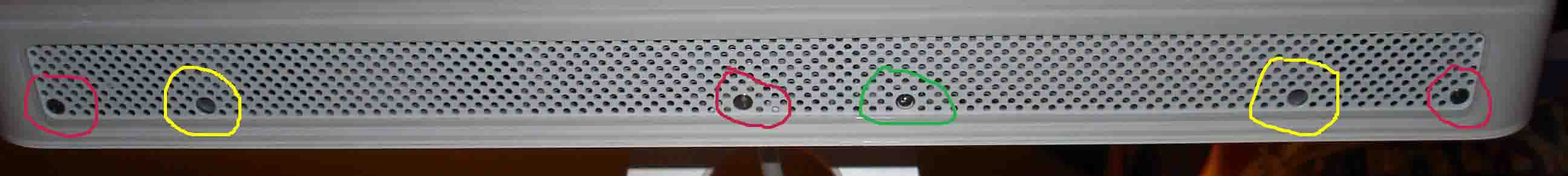

Just for clarification, I've attached a picture of the bottom of my iMac G5.
The screws are circled in red, the ALS in green, and the empty holes in yellow.

Based on the information as to the iMac, the only screws that are even visible from the outside are the recessed screws in the bottom. Being recessed, they can't come out. Have you been running the machine without its back on? I'm not sure how it's possible to lose screws in this machine.
