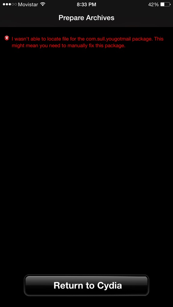

How do I manually remove this package from Cydia?
How do I manually remove this package from Cydia? Image
I snagged this from another forum, it should help you out. (Thanks SellerJ02 on that site, which I don't think I can mention here.)

I've got this message on Cydia
