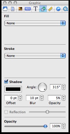

OK, I thought I remembered a simpler workaround and here it is- and yes, it does involve making iWeb treat it as "Graphic Text" (like a Font that you have chosen to use that is not likely to be on anyone else's system like the script font I have chosen to use in a site I am currently working up for a local business: http://www.errors.thinkhost.com/golfguy/The_Golf_Guy/Welcome_News.html )
Make a new text box in the main body of your site layout.
Go to the "Graphic" tab of your Inspector (below)- no not the Text tab! 😉

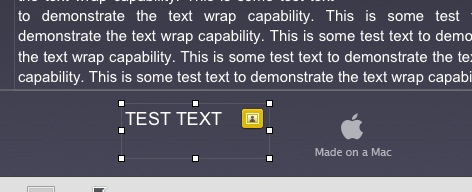

Select the Shadow checkmark and set it to 0 offset and or NO LESS THAN 5% opacity (as shown below also) and the little yellow symbol will appear in the text box as in the second shot below. Make sure "Show text imaging indicator" is selected in Preferences though, or it will not show the yellow indicator.
iWeb will then treat that text box as a graphic and you can do with it what you will. I just updated a single page I posted one time to show someone that iWeb WILL wrap text around graphics and it now shows the result of my TEST TEXT box in the footer: http://www.errors.thinkhost.com/textwrap/Site/Textwrap.html
Yeah, this is kind of a hack/workaround but it works- and should be a lot simpler than involving other programs.

Unfortunately that didn't work...
sicmacdoc -
I followed your instructions precisely and still cannot move the text box or graphic box to the footer. The yellow indicator appears, but it does not move beyond the "line of no"...
