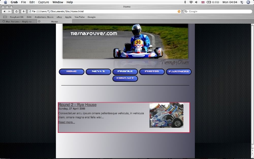

This is what my site looks like though (its not published to the internet yet just to a file).
I see what it is that you need. I would try the almost clear shape on the front of it then I would paste the read more tag on top of it with the link opening in the same window or in a new window as you wish. I think it would be seemless.
