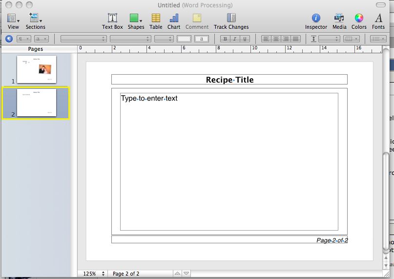

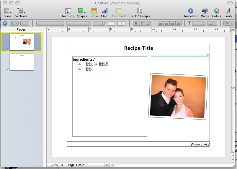

I have attached some screenshots for you to have a closer look at.
What I'm trying to do is create recipe cards. I would like to use the Ingredients page once (twice if I have to, but I don't expect to need to), and add multiple copies of the Method page as I need. Obviously, it's annoying to go to add a new Method section and have an extra blank page being added too. It's causing a lot of difficulties with not only printing the recipe, but also with the linking of text through the text boxes.
