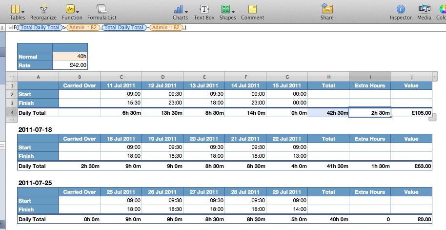

I am new to numbers and new to formulas in general so need some help (please bear with me).
I have just set up my own company and what I am trying to achieve is this, I want to create a spreadsheet which tells me how many hours I work each week and if that week totals/equals over 40 hours a week I want the next column to tell me how many extra hours that is.
I have my week having a total cell at the end, such as G4 = 41.
Another table has the contracted hours set to 40.
I then want H4 (next to G4) to tell me the number 1, or if I work 45, I want it to calculate 5.
I can then lead on to how much that cumulates to over the course of the month.
Is this a simple thing to achieve? Can anyone recommend some good formula sites?

Hello, thanks for the reply, however what I am after is for that 'extra' overtime hours to only contain an entry if over 40 hours are worked.
I think after playing around for a while I may have cracked it in the fact of having:
=IF(Total Daily Total>Admin :: B2,Total Daily Total-Admin :: B2,)
