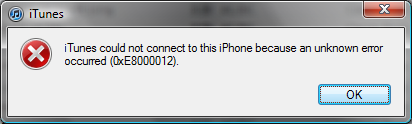

I keep getting this error when I plug in my 4S to the USB:
"itunes error 0xe8000012"
I am getting the same error. I jailbroke my 4s with absinthe 2.0.1 for windows....now i get this when connecting to itunes...

I did a restore and re jailbroke and itunes is able to see my phone. Sucks to have to go through it again but couldnt be more thankful of the guys who make the jailbreaks so user friendly. Good luck.

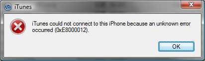

I never had any issue with iTunes connecting to my 4S until after I jailbroke it.
And I run everything as the Administrator anyway.
It sees it fine when the 4S is running Apple's Official 5.1.1 iOS.
When I jailbreak it and then try to connect to iTunes at home, it just gives me the connection error "itunes error 0xe8000012"

may need to re-restore & re-jailbreak
had the same problem with different PCs - one able to see iphone & other being unable to see phone. Solved by restoring with custom IPSW, rerestoring my phone on PC that could see phone (thus 2 restores) and THEN jailbreaking. I didn't choose to set up as a new phone.
The first time I'd just restored with the custom IPSW and quickly ran thru the phone setup. Upon jailbreaking I got a few errors & lost contacts, etc. It was at this point my other PC was unable to see the phone- however the other one was able to still detect the phone.
Anyway, decided to restore again with the same custom IPSW, but chose to also restore the phone with a backup via itunes rather than set up as a new phone. All went fine (contacts, photos, etc) & I rejailbroke the phone with 14b2. It took a loooooonnnng time to set up but eventually got Cydia, etc installed & working, no errors. Today, I tried the other PC with iTunes which previously couldn't detect the phone- detected the phone with no errors & synced fine. My guess is this is a protection so that if someone doesn't get all your info if the phone is stolen. Also, I noted that getting the phone properly into DFU mode is a key.
