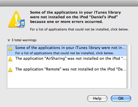

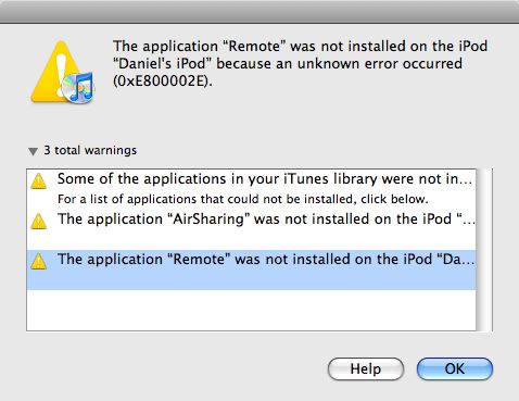

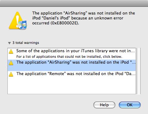

Thanks for the response....I tried to do it exactly as you wrote down, but I still got the the same problem. Below is the window that pops up in iTunes, and the three error messages. The exact error code is 0xE00002E. A quick Google search for the error code turns up a lot of questions, but no solid answers. I'm just hoping that someone here has one.

Have you tried the mobileinstallationframework patch yet? Super easy to do these days, you don't even have to SSH like we used to 🙂
From Cydia, search for and install the patch-should resolve the problems.
NOTE: SOME APP STORE APPS require 2.2-constitution for iphone/ipod being one of them-worked fine for a long time then just quit. When I finally got around to jb 2.2, it reinstalled and started working again...
Mobile patch
I have this same problem and can't upgrade 2.2 apps, where do I get the mobile patch? I searched cydia but couldn't find it
It's called mipatch I believe. I just dl'd it because I had the same issue.
Now it works great! Thanks Enigma.
This happened to me, and what I did is I installed the MobileInstallation patch from Steffwiz on Cydia, and the problem went away.
