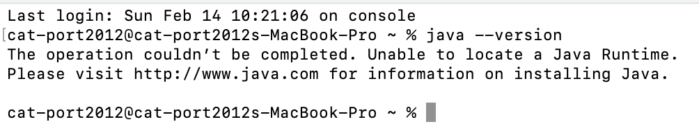

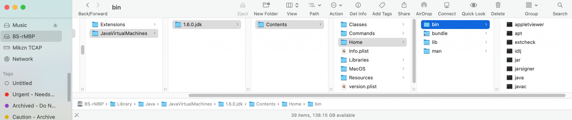

As per previous thread see this Catalina OS thread - I tried to install the legacy version of Java 6 runtime on Big Sur and the Java package seemed to install ok - /Library/Java/JavaVirtualMachines/1.6.0.jdk
After the install pkg "seemed to run fine" and reported "install sucessful" - checking with "java --version" in terminal - I get "operation could not be completed - unable to locate Java Runtime"

As far as I can tell (so far) it may not work on Big Sur - I am able to install the files succesfully with the Catalina Link as per above - post #1 - the files are installed in the same location as in Catalina - but the JAVA_HOME does not work and is not recognized by macOS Big Sur

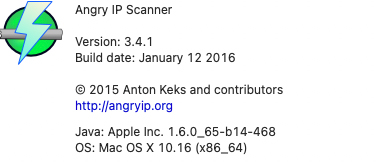

Here is how I got Angry IP Scanner 3.4.1 to run on Big Sur:
1. Download Java from Apple https://support.apple.com/kb/DL1572
2. Create a package that can be installed on Big Sur (same script as for Catalina)

8. Drag and drop the executable file of the app, in this case /Applications/Angry\ IP\ Scanner.app/Contents/MacOS/ipscan
9. Press enter and good luck! 🙂
