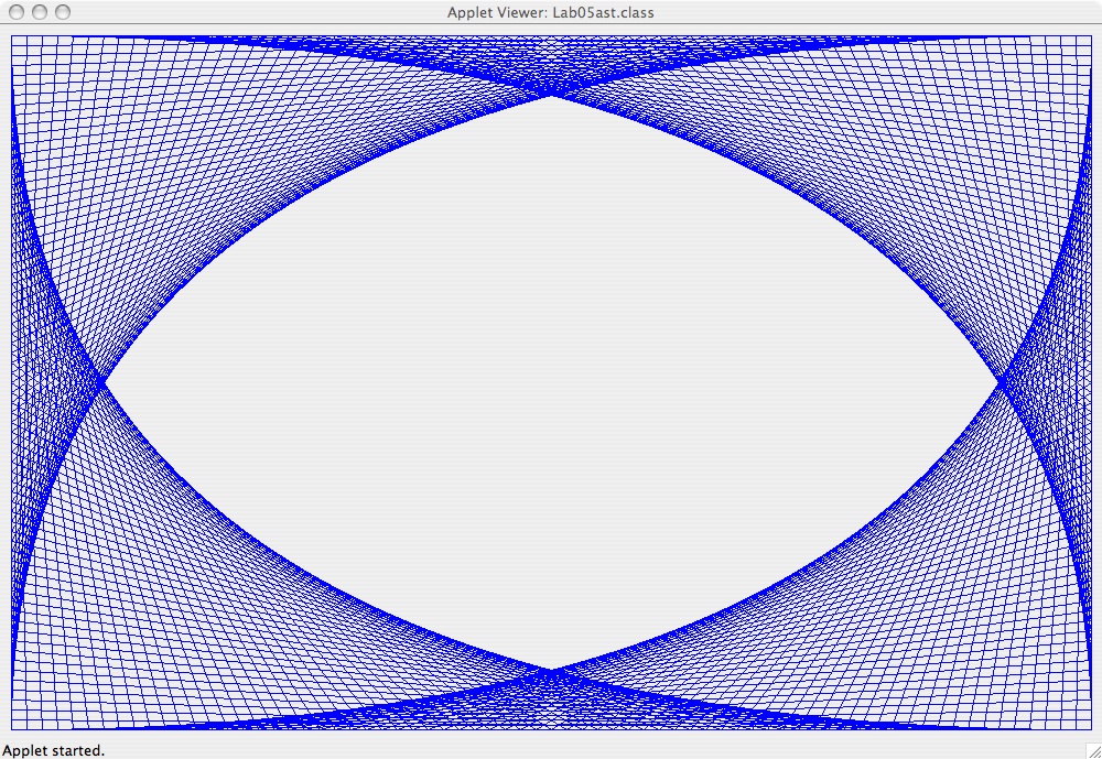

well what i need to do is draw that one in at least the 80 point version
The teacher gave us this formula to use
Start + n(total distance traveled/# of repetitions)
but every time i plug it in I am not getting anything like the picture in the instructions...
I have this so far
for(int x=0; x<60; x++)
g.drawLine(10,10,10+x*(630/60),640)
I have this so far

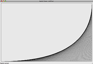

What are you getting?
this...
Edit: Nevermind, not a caching problem. You're getting exactly what you want.
Look at your loop more. Write down the coordinates you want to get, and what you do get:
You are drawing from:
(10,10) to:
(10,640),
(20,640),
(30,640),
(600,640)
Is this what you want?
-Lee

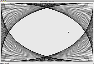

so what would I use to recreate this? (This is the task that is assigned in the lab sheet)
I don't know why he would give us that formula if it will not work to make this..
http://www.mathsisfun.com/greatest-common-factor-tool.html
Or... math, will get you the GCD. Even without that, you just need to tweak your algorithm.
You're only moving where the line ends, not where it starts. You need to do both. I shouldn't be too bad. For one, you are starting in the upper left corner, (10,10). You need to start in the upper right corner, which is at (990,10). You may have to add and subtract to solve this.
Also, get off of the windows.
Use javac to compile your class on OS X from the terminal, then run:
appletviewer ./Lab05ast.html
Java is cross platform, and something like this does not require an IDE. When you get to the point of needing an IDE, there are others that are cross platform that you can use on OS X.
He gave you part of the solution, not the whole thing. It wouldn't be serving you if he did the legwork for you.
