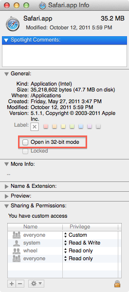

For web apps, you have to launch Safari in 32-bit mode. You can do this by clicking on Safari, going to File, then Get Info…, and clicking the box that says "Run in 32-bit mode."
There is no 'Get Info' option to run in 32 bit mode!
:confused:
Wirelessly posted (Mozilla/5.0 (iPod; CPU iPhone OS 5_0_1 like Mac OS X) AppleWebKit/534.46 (KHTML, like Gecko) Version/5.1 Mobile/9A405 Safari/7534.48.3)
You don't see this checkbox?
Remember, this is from the Finder, select the Safari application, and choose File -> Get Info (or hit Cmd-I).

Awesome...!
