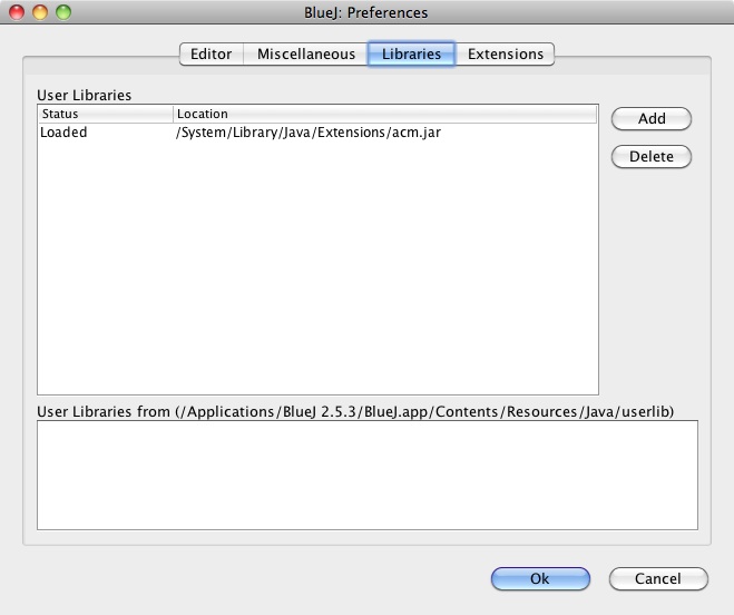

The reason the BlueJ IDE is complaining about the package "acm.program" is probably because you haven't added the acm library to your project yet. Locate the "jar" file that is the ACM library and copy it into the BlueJ/lib directory. I'm familiar with the BlueJ IDE but the internet tells me that's where you place your library files.

Its hard to see the path in the attachment where I placed my 'acm.jar' file. It is '/System/Library/Java/Extensions/acm.jar'. The 'acm.jar' file is located in my Extensions directory with a list of other files ending with '.jar'. My coding still won't compile using BlueJ. I get 'Cannot find symbol' and that error message is pretaining to: 'public class Add2Integer extends GraphicsProgram' when I try to compile. Did I put the acm.jar file correctly as you suggest?
