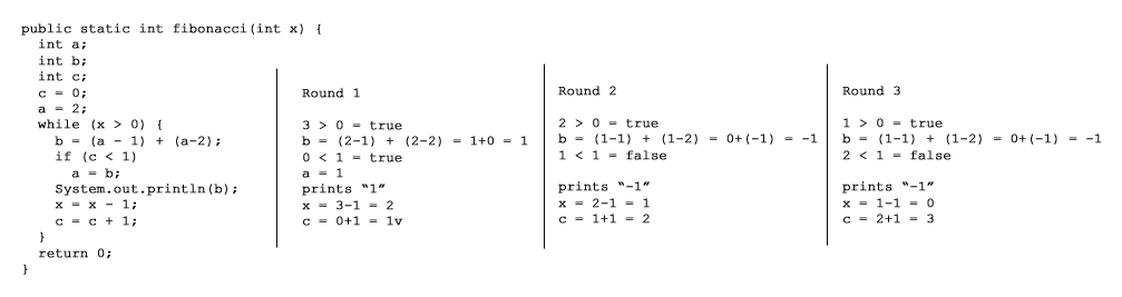

Here's an example of what the others ment by pretending to execute the code. I assume that x starts out being set to 3 in my example. See what happens:
