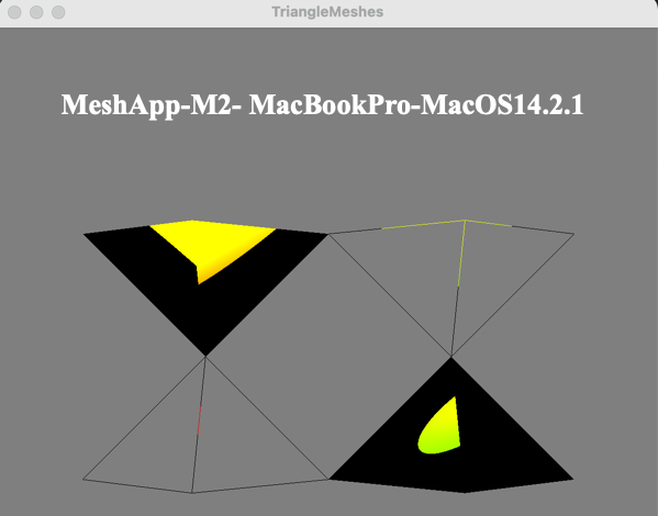

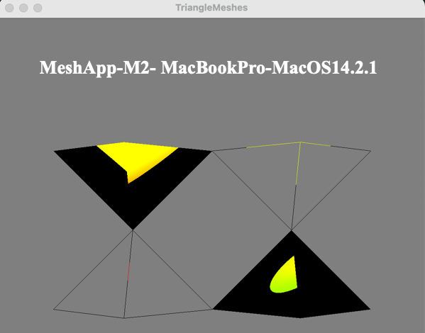

b) A M2 MacBookPro with Mac OS 14.2.1 with serious PointLight-AmbientLighe rendering issues
I have attached screen snaps below:
a) No issues screen snap:
b) Rendering issues screen snap: See attached
Have others had JavaFX issues with Mac OS 14.2.1? I trying to determine if this is a M1 issue, and M2 issue or an Mac OS 14.2.1 issue.

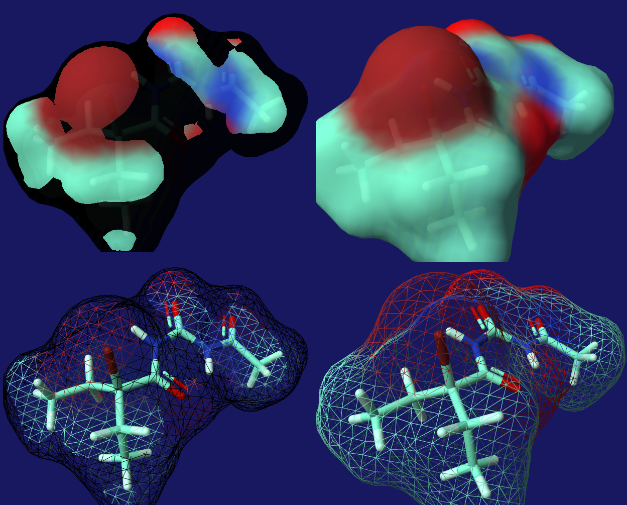

I can confirm this issue on MacBookAir M2 on Sonoma 14.2.1:
Left side is: MacBookAir M2 Sonoma 14.2.1, Liberica full JRE 21
Right side is how it should look like, in this case on Ubuntu, Liberica full JRE 21
The problem only exists with a multi-color mesh. Filled or triangle surfaces with one color only are correctly displayed.
