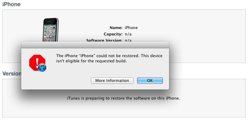

Thank you so much TriJetHero, here's what I did:
1. Downloaded 5.1.1 208 version for iPhone 4 GSM
2. Created custom IPSW with redsn0w 0.9.13dev3 (is this a good version or I should use 0.9.14b2?)
3. Put my phone into Pwned DFU with redsn0w (I did save my SHSH/APTicket with redsn0w at this point with SHSH/Fetch)
4. Open iTune (Mac version 10.6.3 (25)) and hold "alt/option" key then click Restore
5. Select the NO_BB IPSW created based on the 5.1.1 208 IPSW
6. iTune finished extracting, then go to verifying iphone restore
7. Pop-up shows up saying "The iPhone "iPhone" could not be restored. This device isn't eligible for the requested build."

Hi TriJetHero, now with my phone restored back to 5.0.1, I redownloaded the 5.1.1 208 IPSW from iClarified and then use the latest redsn0w 0.9.14b2 to create a custom IPSW.
After that I put my phone into PWNED DFU with redsno0w and then launched iTune to restore my phone with the NO_BB 5.1.1 208 IPSW. Right after extraction and verification, the same error message popped up as followed. Any idea on what could have gone wrong? Thank you very much for all the help

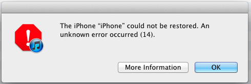

Hi TriJetHero, with regular DFU it seemed to have moved a little more but still stopped at the beginning of the iTune restore. It showed an error 1600 as follow. Any thought or idea on what could be wrong. At the mean time let me try to do this on Window. Thanks very much again.

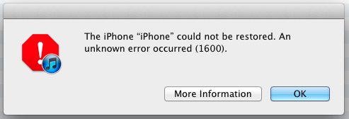

Strangely I restarted my Mac (I haven't yet restarted after updating iTune) and then restore again (under PWNED DFU) and the process went further. It was able to load up the APPLE icon and progress bar on my iphone. However, as soon as the progress bar started moving, an error 14 occurred (See attached).
Now I really don't know what is going on. It seems it can only go back to 5.0.1 but cannot move up anymore. Please any help here? Thank you very very much!

finally got it to restore to 5.1.1. I stopped using the 208 and tried the 206 version after restarting my Mac and it worked. I think the problem earlier is that I did not restart after updating iTune, although it did not ask me to, I should always restart.
Then it was just the problem with 5.1.1 208. Wonder what's the difference between 206 and 208. It's kind of tricky, I mean I would have thought that 208 is better but in this case 206 works.

From the iphone wiki
Error 14
Custom firmware update fail (PwnageTool until 4.0.1). You have to restore the device with a custom firmware. Update to a custom firmware isn't working. Device isn't bootable. 2
USB Problem. Check the USB connection and try other direct ports or maybe the USB cable is an older one. Device isn't bootable.
You're trying to 'update' to a beta firmware instead of performing a restore. Device is still bootable if you kick it out of recovery mode.
Rebooting your Mac or PC may resolve this issue.
Root file-system partition size was set too small in the ramdisk's options plist.
The preserved BB doesn't effect it, enjoy you phone!
