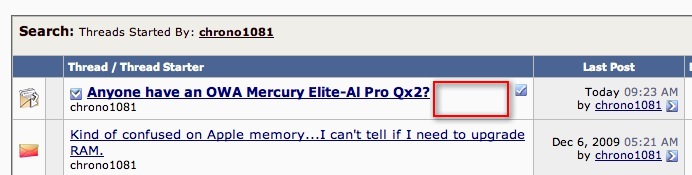

You probably already know this, but if you're interested, you can correct your thread title by going here and double clicking in the area I indicated here:
It might catch the eye of more who are familiar with OWC.
lol actually I didnt know that. I was going nuts trying to figure out how to change the thread title. Thanks for the tip 😀
