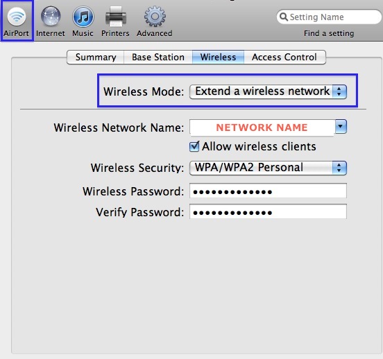

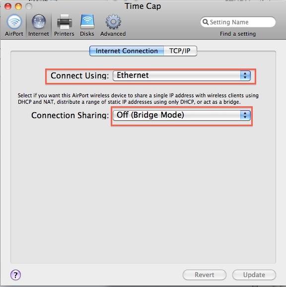

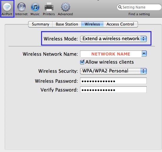

Assuming the owner has the Airport Express configured for a wireless network, you would need to set up the Airport Extreme to "Extend a wireless Network". I have a similar setting on my home network:
You are selecting therefore, to extend the above network, so would choose the Owner's named network. HOWEVER, on the Owner's network setup, he would HAVE to have checked on HIS side - "Allow this network to be extended" in his "Wireless" tab of Airport Utility for the Express. Without him doing this, the above is NOT possible.

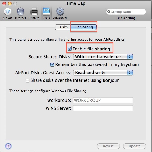

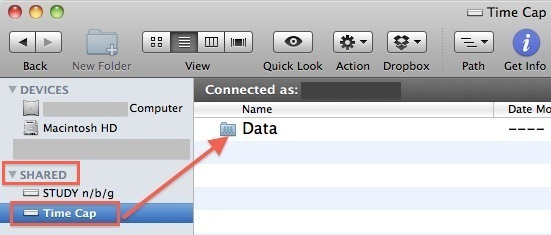

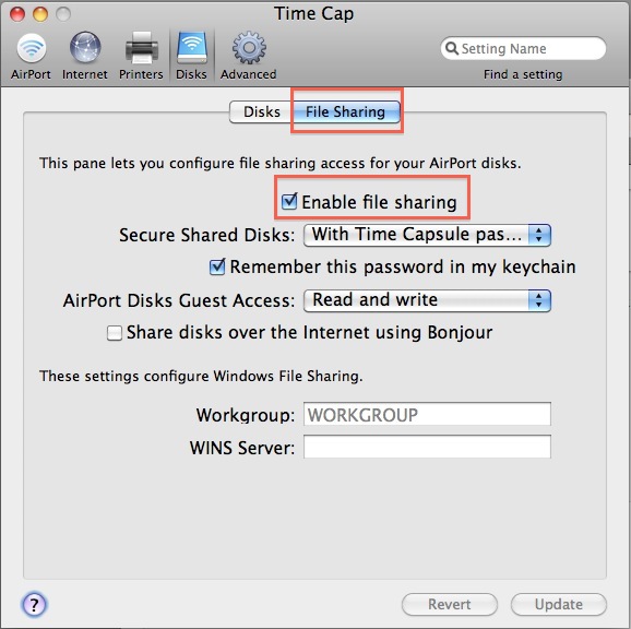

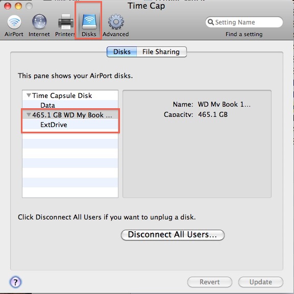

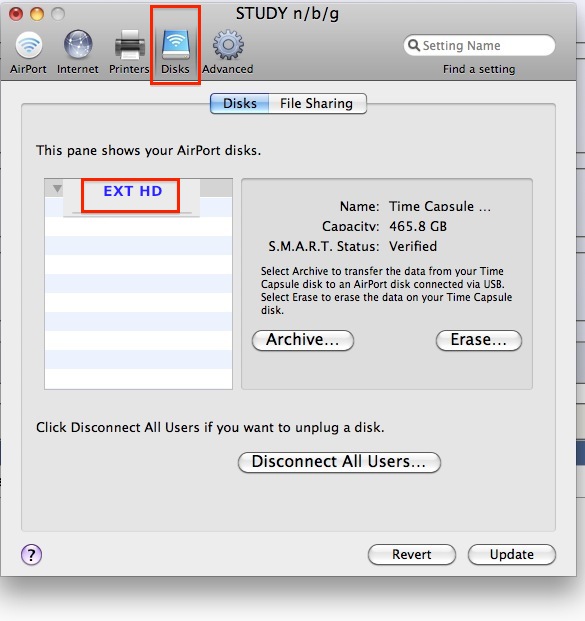

I assume your external HD is connected via USB to the Airport Extreme. This is configured in the "Disks" tab:

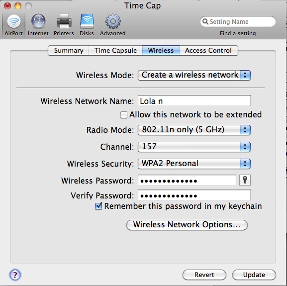

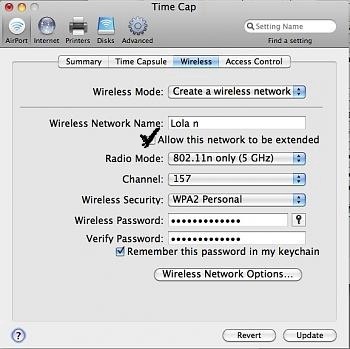

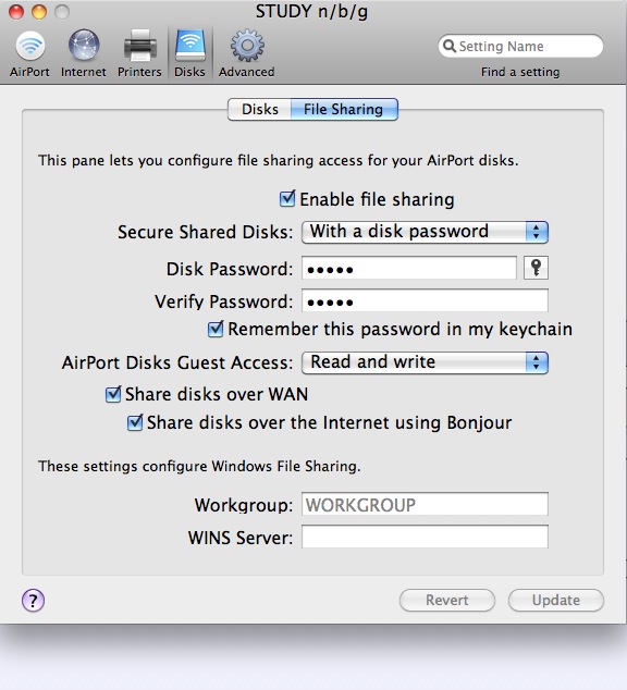

You would also want to enable file sharing from the External HD. Mine is setup as follows:

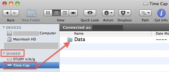

To access the Ext HD from your MBP, it would now appear under "Shared" volumes. Again, a pic of my setup (slightly different because I am using the internal storage of the Airport device, actually a Time Capsule, but the principle is the same):

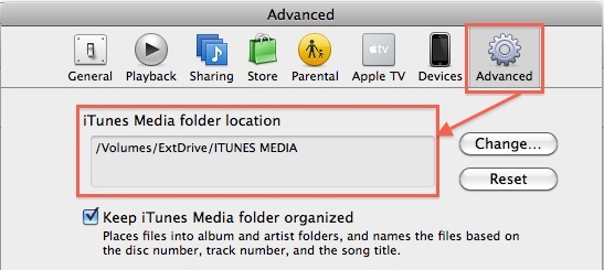

One question though - is your entire Itunes Library stored on this external drive you want to access via your ATV? If so, this would have to be configured in your iTunes preferences in order for the ATV to "see it". I have the ATV first gen, so my setup is somewhat different. I do have all my media on an External Drive:
Hope everything is somewhat clear.🙂

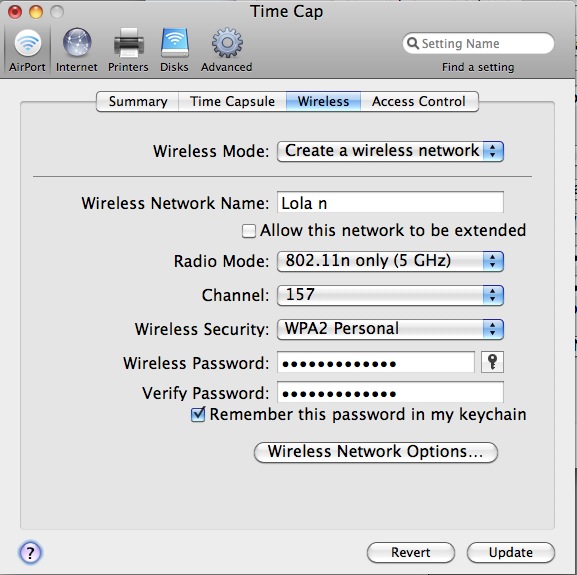

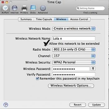

My AEBS, called "Time Cap" is connected to the primary base station via ethernet.
Still not sure though, if this would work, because you would still have to configure the "Wireless" tab for some type of network setup.

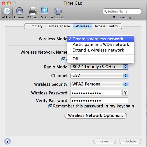

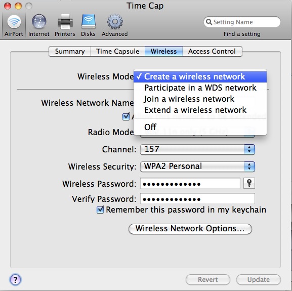

I did think of something else. In the Wireless Tab:
See if you have the option to "Participate in a WDS Network". If so, you could configure one device as your "Main" and the other as your "Remote". I had that setup before I did the Dual Band network. (again, not 100% sure this will work in your particular case.)

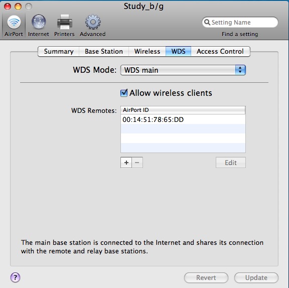

First thing to do, so that you have this to go back to if new configuration does not work: Using Airport Utility > Airport Express settings, go to "File" in top menu bar, and select the option to "Export Configuration File", and save it to your desktop. That way, you can always choose to go back to that using the "Import" option in the same setting.

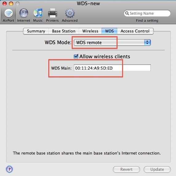

Then try the setup wirelessly first.I would go ahead and try setting up first with the WDS configuration.
If this does not work, then you can connect the two with an ethernet cable and hide it behind that huge plant.😉
Again, I am shooting blind here, so not sure if it will work, but here goes:

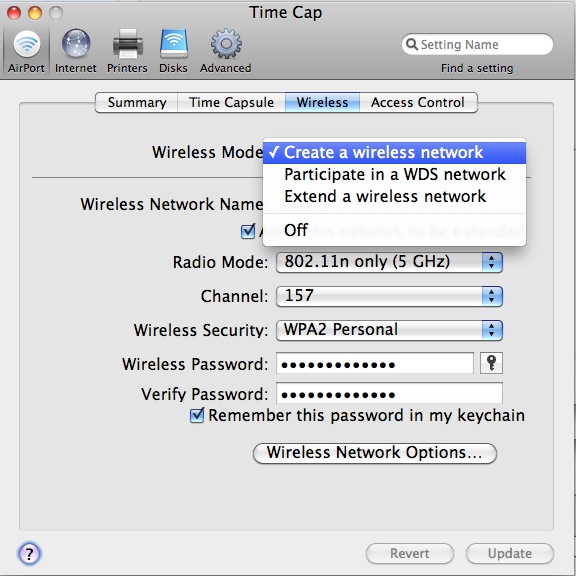

1) In the "Wireless" tab>"Wireless mode" (first drop down menu), select the option to "Participate in a WDS network". You would choose in the next setting, the network name you are currently joined to.

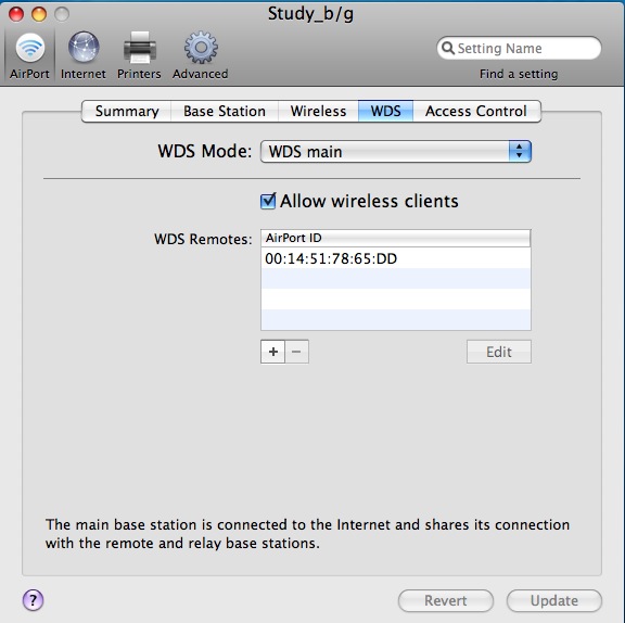

2)The menu bar within Airport Utility window will change, showing now a new "WDS" tab. First menu option is "WDS Mode". Select "WDS MAIN".
2) CHeck "allow wireless clients".

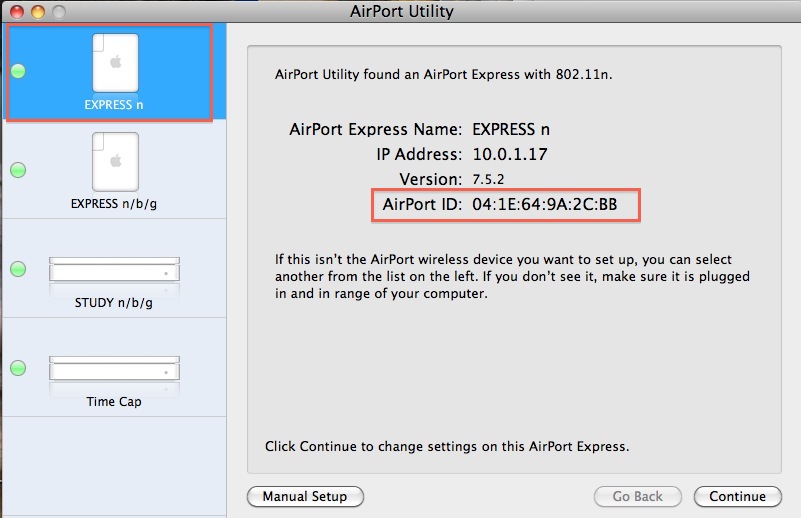

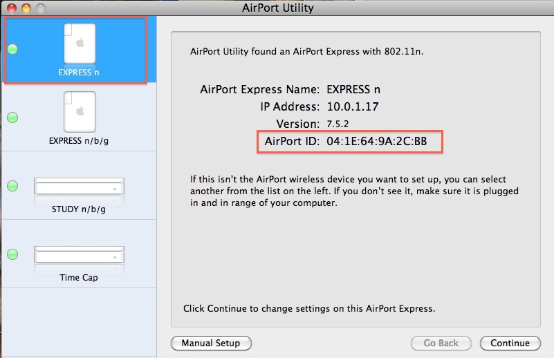

3)In the "WDS Remotes" window, you will need to enter the Airport ID of the AEBS. This can be found in the Summary pane of the device:
4) Hit the update button. (Remember, you have that exported config file as your backup, just in case.)

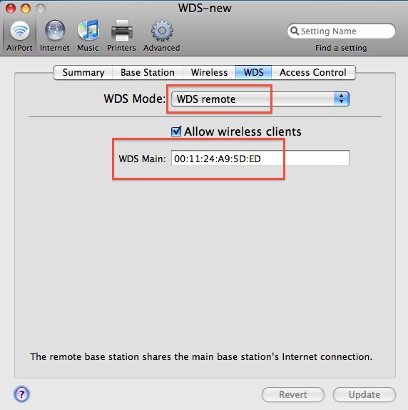

5) Now to setup the AEBS, go again to the "Wireless" tab, and select the option to "Participate in WDS network".
6) In the "WDS" tab that appears, you would set this device up as the "Remote".
7) In the window below, you would now enter the Airport ID of the MAIN base station. (again, you will find this in the summary pane of the AEBS (as above); again check "allow wireless clients".
8) Hit the update button.
9) Start praying.😛
With all of the above, if this works and your EXT dr is connected via USB, and configured correctly in the "Disks" tab, you should be able to access it.
Edit: the pics above are from my older Network settings, but should still apply.

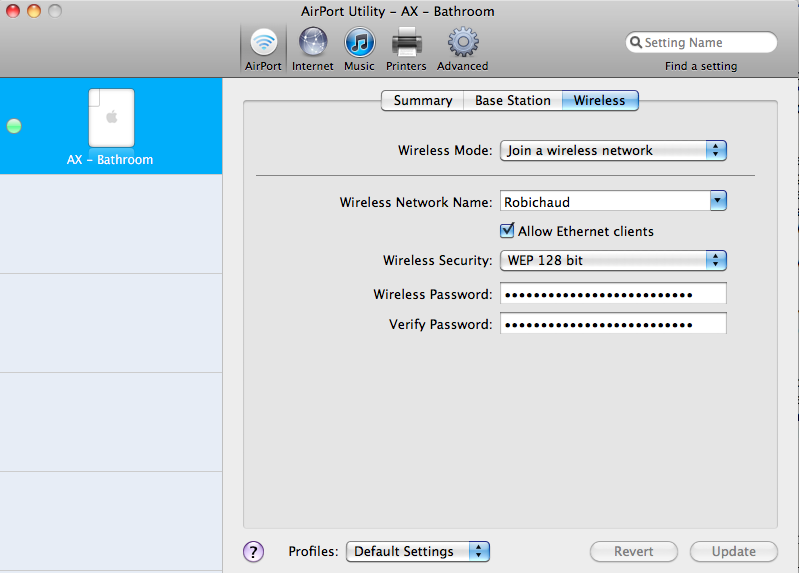

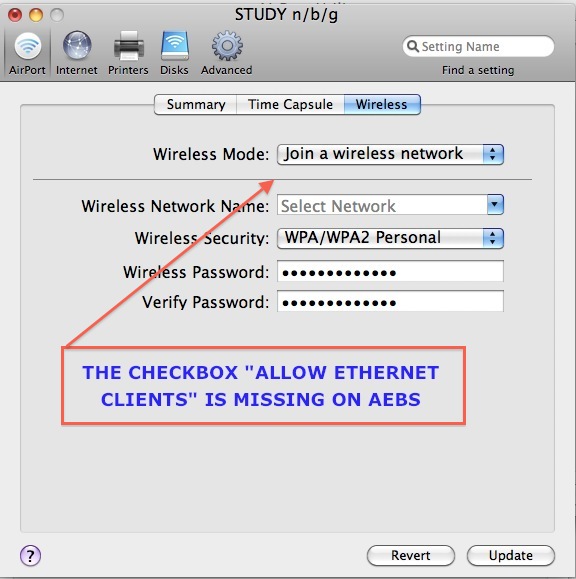

Screen Shot
Here is a screen shot of my Express as it is now. It's just "Joined" to the Owners Network.
I have a bunch of External HDD's and once I get the AEBS up and running, I plan to plug in one of them.
That is exactly what I was looking for to answer my question. From your pic, you can see that the Air Express does allow, and has a check box for "Ethernet Clients". Unfortunately, the Air Extreme has no such function when set to "Join an existing network".🙁 See mine:
The only thing I can now think of, is to keep your setting on the EXP exactly as is, but connect the EXTREME via ethernet. You could then see what configurations are allowed by this physical setup in Airport Utility. What I am thinking, is to set up a completely separate network, one that does NOT connect to the internet, but would just provide wireless access to any USB device connected to the Extreme.
What I want you to do, is when you select in the Airport>Wireless tab>Wireless Mode - hold down the OPTION key while doing so. This should give you more choices than just the basics you saw before. What it would look like without holding down Option key:
Holding down Option Key:

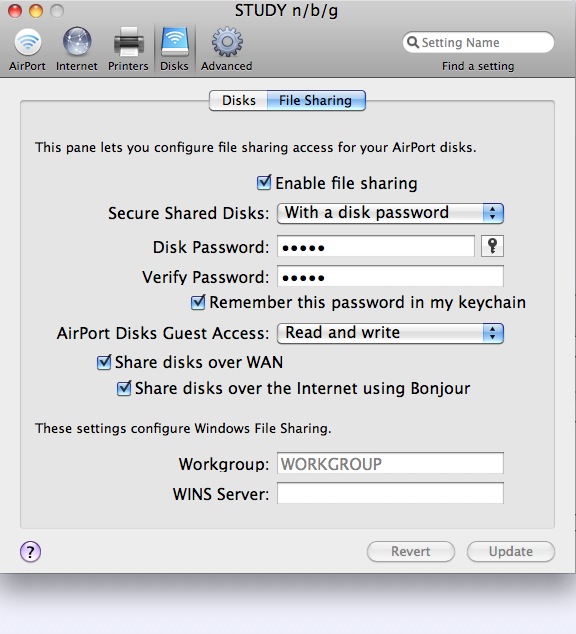

"I have a bunch of External HDD's and once I get the AEBS up and running, I plan to plug in one of them."
Don't forget, they would have to be A/C powered; the Extreme does not have sufficient power for a bus driven USB external.
Once your setup is done with the Air Extreme, depending on the above, the configuration of the External USB drive is simple. Pic of mine (You can see the Western Digital "ExtDrive":
From there, you would set up File sharing, encrypted if you wish:

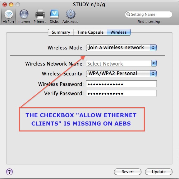

You don't have the option, "Participate in a WDS network" because you have a newer Airport Extreme/Time Capsule. In this case the configuration is actually even easier. All you need to do is check the box "Allow this network to be extended", :
On the remote base station, you would configure the Wireless Tab to "Extend a Wireless Network", and select the name of the network you are Extending.

Airport Express can "join a network", but Airport Extreme cannot..
I don't know if the op found his answer, but I found out through trial and error (and discussions with Apple reps at the Apple store), that an Airport Express can "join an existing network", but the Airport Extreme cannot do that. The only option available for an Airport Extreme is to "extend an existing network". That may not be the ideal situation for some people. It was not the ideal situation for my home network set up.
So IF you are interested in setting up Airport base stations to just "join" a network and not extend it, you'll have to use an Airport Express—not an Airport Extreme.
My set up:
One (1) Airport Extreme (main Router connected to the cable modem) - WiFi network created from the Airport Extreme
One (1) Airport Express "joined" to my Wifi network, which is then connected to my 1AV equipment for Airplay)
One (1) Airport Express (newest version) "joined" to my Wifi network, with two laser printers connected to it via ethernet (you can use both ethernet ports for your ethernet connected printers I found out one day).
One (1) Airport Express (older version) "joined" to my Wifi Network, which is connected to a set of speakers in my laundry room, for Airplay
I LOVE my set up. Screenshot attached.
