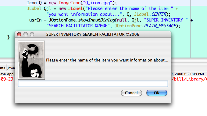

one possible solution
Hi everybody.
I have a solution that works (for now) for this problem. I went in and tried all kinds of
different combinations of OPTIONS and MESSAGES in JOptionPane and on the mac they
are all sort of goofed up; wrong icons etc.
I took one posters suggestion and learned how to setLookAndFeel. That was OK for a
while but I never really got what I was after. One of the varieties looked like CDE on solaris, yuck.
So, I was doing some reading and came across this: a way to add any of my own photos (after resizing)
to JOptionPane as an icon. I may be wierd but I thought this was very cool and simple. Check the thumbnail
below for the code snippet and a smple JOP. This maybe old hat to some out there but I really got a kick
out of playing with it.
