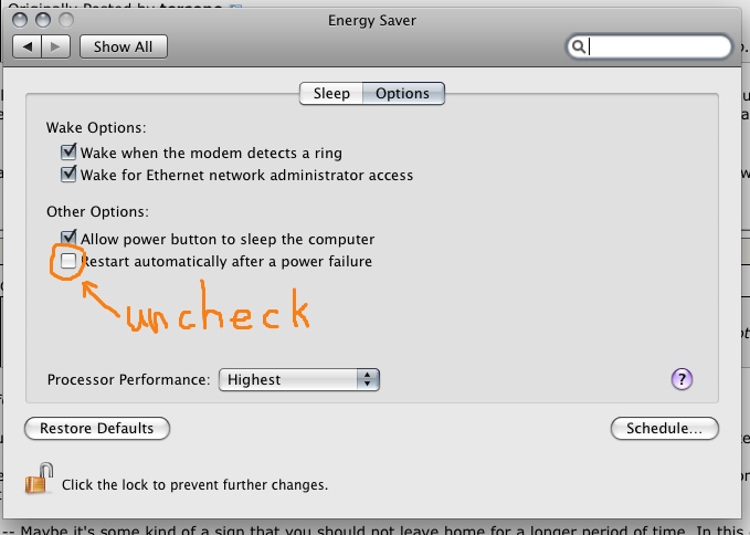

There is an option in the Energy Saver panel in System Prefs. Just uncheck the "Restart after Power failure"
