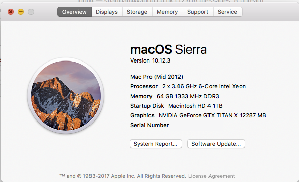

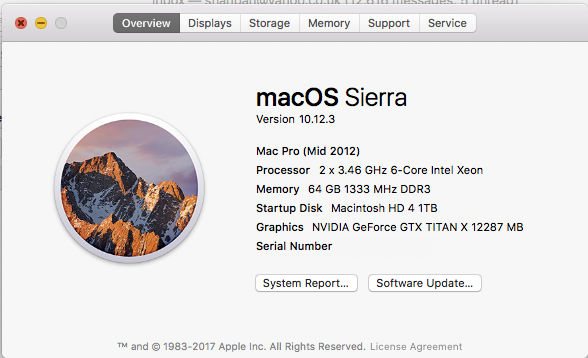

It is a frightening prospect, but open her up and let her have 3.46gb (6 core) x 2. Cost me £310 and some wobbly moments, but I did it (I am a normal - not a pro engineer person 🙂 Just make sure there are no children, or questioning wife near you when you go for it 🙂 I stuck in a Titan X Maxwell 12gb for £440. Seems okay. SSD died, new one comes in a few days. Can't justify going to 128gb of RAM until the prices start coming down.

The 3D rendering is much faster - very noticible. The machine is quick. And for £310 the processors seemed a no-brainer when you consider the cost of a 2 x2.4 vrs 2 x 3.46 on the secondhand market. If I decided to sell it again I'd get more that £310 worth of value back. I have a OWC Acelssior E2 SSD, that is faster than buying an SSD and sticking it a sata drive - much faster. It's raided dual blade SSD and takes advantage of the PCI-E speed. The Titan X (with external PSU) is a monster and frankly over-kill, but I thought "well, I've come this far, let's do it). The 64gb of RAM isn't expernsive – but the 16gb modules are, so that 128gb have to wait. 64gb is pretty roomy for now.
Check out the GeekBench scores, or Barefeets and you can see that something like mine is about 5%-10% off a 6,1 Mac Pro. If you need power, you've got the right starting point. If you want something with a limited range then an iMac will be fine (until the GPU dies, which I have seen four times).
Like everyone else in the world will tell you, it depends what you'll use it for. For me an iMac is a consumer product. I need loads of cores and fast ones at that. So in answer to your question – I'm a happy man. I wasn't going to buy a 6,1 that's three years old with outdated everything.
Only tiny issue I have is the screen sharing which I think I have an answer to (GT120 in there doing nothing - I'll report back).
Personally, I'd do the CPU upgrade either way. You'll make more money from it if you chose to sell it and get an iMac. Or you'll have a nippy machine if you keep it. That is just my opinion however - do check your local eBay prices.
