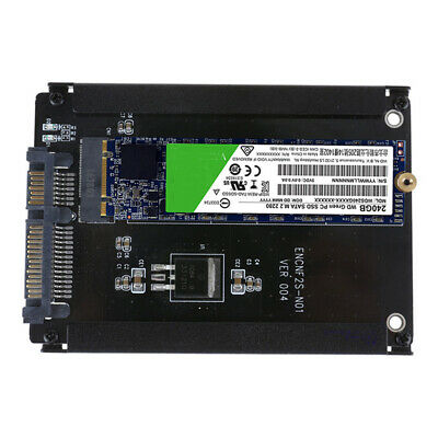

This?
yes, but you will need cabling to a sata port, so speed is just same. If not using a nvme blade its wasting a pci port.
also you need additional heat sink for the nvme part.
i have such dual nvme / sata Blade cards with a fan. This kind or with snap on heat sink. If one uses NVMe, otherwise its wasting a port, as written.
