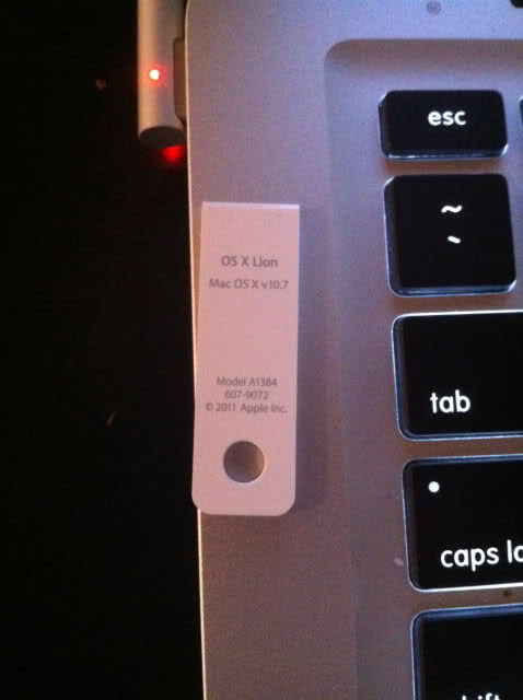

I own a 5 of these drives. and just finished installing one yesterday on my MBP 13 with Lion. (First time installing with lion)
I've also done a clone of another hard drive onto SSD using my MBP 15 running 10.6 and encountered problems a short while after, ended up doing a fresh install and all was and still is fine, that's why I wouldn't bother with that.
You're better off just moving the files you need and doing fresh installs of your apps. (My personal experience)
The correct way to install the drive is to first format it to
Mac OS Extended (Journaled) using disk utility.
You would then install the drive into the machine.
(You will need a Torx 6 bit for the screws on the HDD along with a phillips bit for the plate on the bottom of your MBP and please don't forget about the bracket holding it down better yet watch an install video 😉
Once you have the SSD installed I believe you will hit Option-R after/during the chime to enter Lion Recovery , this will then allow you to download and install lion but I'm not 100 percent sure about that I used the Lion USB
(Can someone confirm that Option-R is correct.)

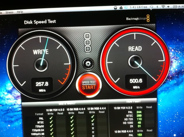

Once the setup is done if you're at all interested in the speed of the SSD
I ran some test using Blackmagic disk speed test
Here are my results on the 13 inch using the 256 Crucial M4
