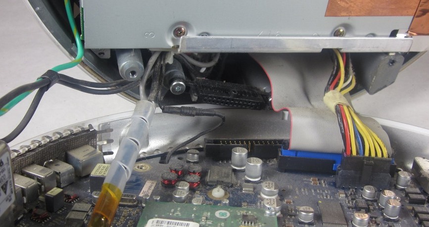

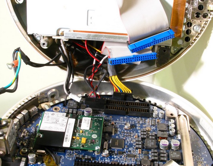

A good find for $45! I still think that the G4 iMacs are underated by many, and have a lot going for them - especially the later 1GHz and 1.25GHz USB2 models. I've torn-down and refurbished quite a number of these and so far have retained them all, much to the chagrin of my little lady.
The earlier models imho are slightly more difficult to work on, particularly to re-assemble the bottom housing to the main body. This is due to a 'floating' female connector within the main body, which must be carefully mated with the fixed connector within the bottom housing whilst reassembling top to bottom. I have seen cases where the 4 torx screws have been inserted and partially tightened before correct alignment with the aforementioned connector. The following helps to illustrate:
Early 700/800GHz model. Care required to correctly align connector (in centre of photo).

Later USB2 1GHz & 1.25GHz model.

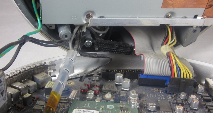

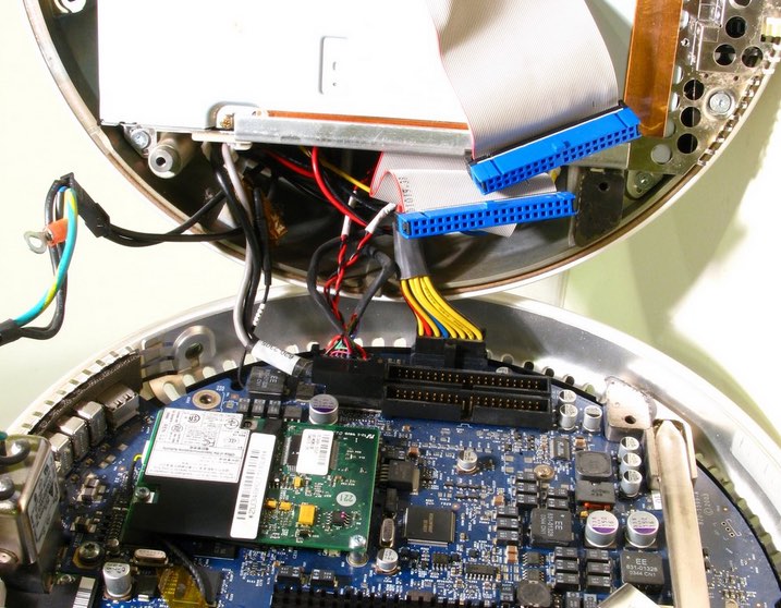

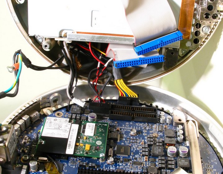

HERE's an additional link to a previous post, where I show the installation of my SSD.
This was the cheap model IDE to SATA converter, as even after a good clean with isopropyl-alcohol one can still see white residue from solder paste.
It should also be noted that this is a 17" 1.25GHz model, so the fan you see in the bottom photo is probably NOT the same as yours. At a guess your's is probably a Panaflow model, but check whilst cleaning inside. It's rare that these require replacement.
