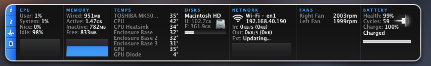

Nice work. I closed all apps and disconnected the cinema display and the temp dropped considerably after a few minutes. Does this still look too high?
It's ok but the temps were high with the acd connected. Problem is which is easy to explain with the picture is the size of the CPU die its huge and it leaks heat up to the GPU with the bad over paste and poor surface. When the AMD activates some of the heat cant be drawn through the heatsink and with the big over paste on the GPU too it gets transferred to the pcb part of the GPU putting heat where it shouldnt go breaking the solder balls on the package. With 80% less paste there is only air between the pcb part of the GPU and the heatsink so the heat stays off the pcb surface of the AMD.
Repasting and polishing I have done as a preventative measure on mine and a dozen other 2011's and none has broken their GPU. Apple don't do it this way get an independent engineer to do it until they change their engineering guidelines which quite frankly for these units are nuts.
