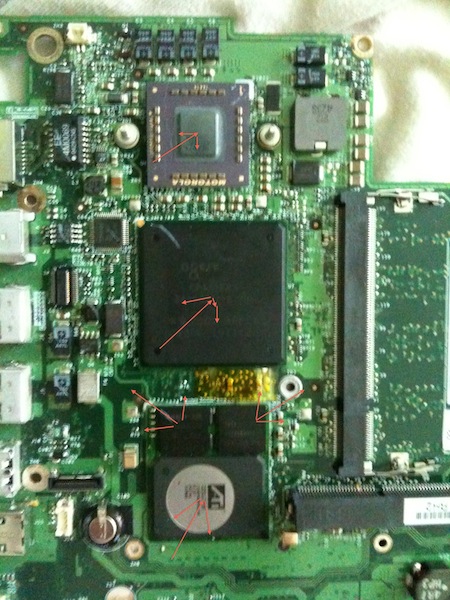

So I'm waiting on the logic board to come in, I plan on using thermal paste on the processor etc. I know less is always best so I plan on going really easy with the stuff. Any other tips you guys have?
Brace the cracked case. Internal integrity will prevent things working loose. You're right about the paste, use it sparingly. Also, as I have found from replacing a Toshiba laptop's HDD, double-sided tape does not solve the issue of missing screws.

Thanks for the reply. 🙂 I did order a whole new metal chassi so those cracks won't be a problem anymore. And also a
whole new screw set for the missing ones. For the thermal paste right
to the bottom of the CPU there is large
black chip, should I put a small amount on and
spread to cover the entire chip or put a small amount on and spread it out a little?

So I should apply the paste where the arrows are pointing and spread it out to cover? On the processor, should it cover the silver metal part or the whole thing? Just double checking things. 🙂

On the processor, only on the silver bit, it'll be most efficient. Everywhere else, apply cautiously and spread evenly over the chips, being care not to get too much if any paste onto the processor board.
