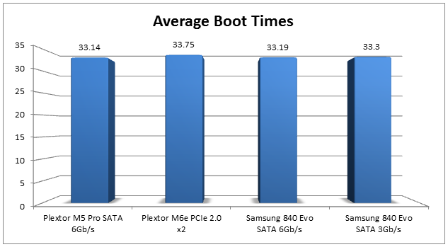

If you machine can boot in 20 second with the SATA SSD. Guess what? It can also only boot more or less in 20 seconds with the PCIe SSD.

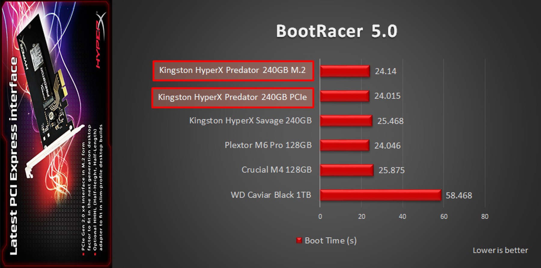

The PCIe HyperX Predator can't even beat the Plextor M6 SATA SSD in the boot test. However, obviously all SSD require more or less the same time to boot.

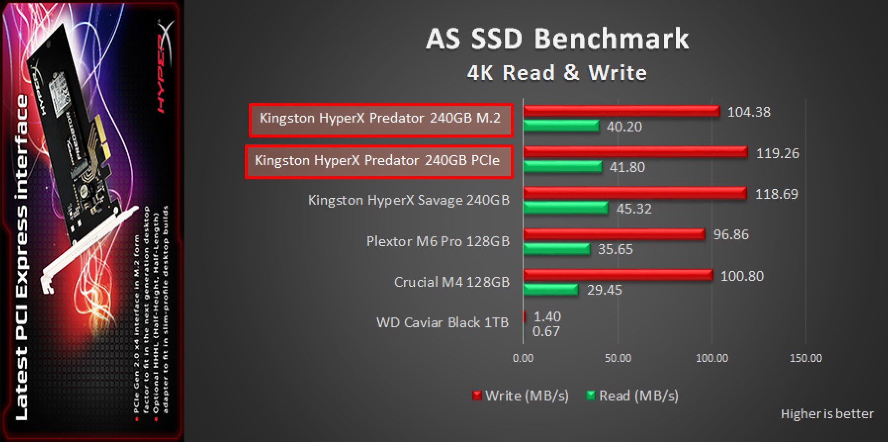

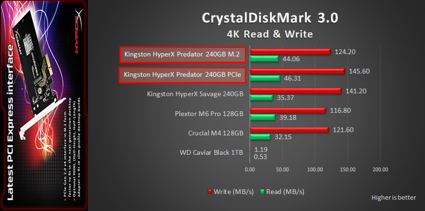

As you can see, the HyperX Predator 240GB M.2's random read speed only around 44MB/s. No where near the SATA 2 bandwidth limit. Therefore, M.2 or PCIe connection won't improve anything in the random read performance.
You may argue that the PCIe SSD still better than the SATA SSD a bit, however, not always true.
In the above test, HyperX SATA SSD win the 4K read test, it's about 10% faster than the M.2
The PCIe HyperX Predator can't even beat the Plextor M6 SATA SSD in the boot test. However, obviously all SSD require more or less the same time to boot. View attachment 661905
