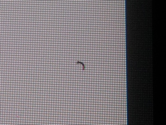

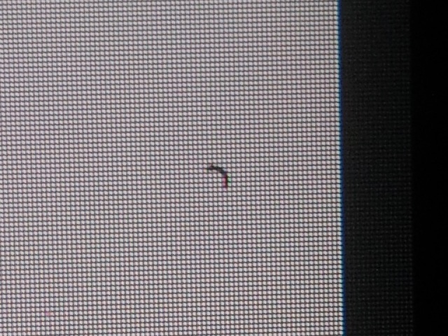

One more thing it has what I think is a hair or something under the glass...
It never eliminates the issue. But it does reduce it significantly to the point where it's not a distraction anymore (in my opinion).
That hair, though? That would bug the living crap outa me!
The "hair" does bug me but the screen is so big that i can't watch it all at once and its bearable while I test the whole machine see if there are other problems, but the yellow tint is an issue that apple accepted as a defect and a hair under the screen is definite cause for an exchange. I have to wait till monday anyway because the reseller is not open on the weekend (the department that deals with BTO which is not a retail store).

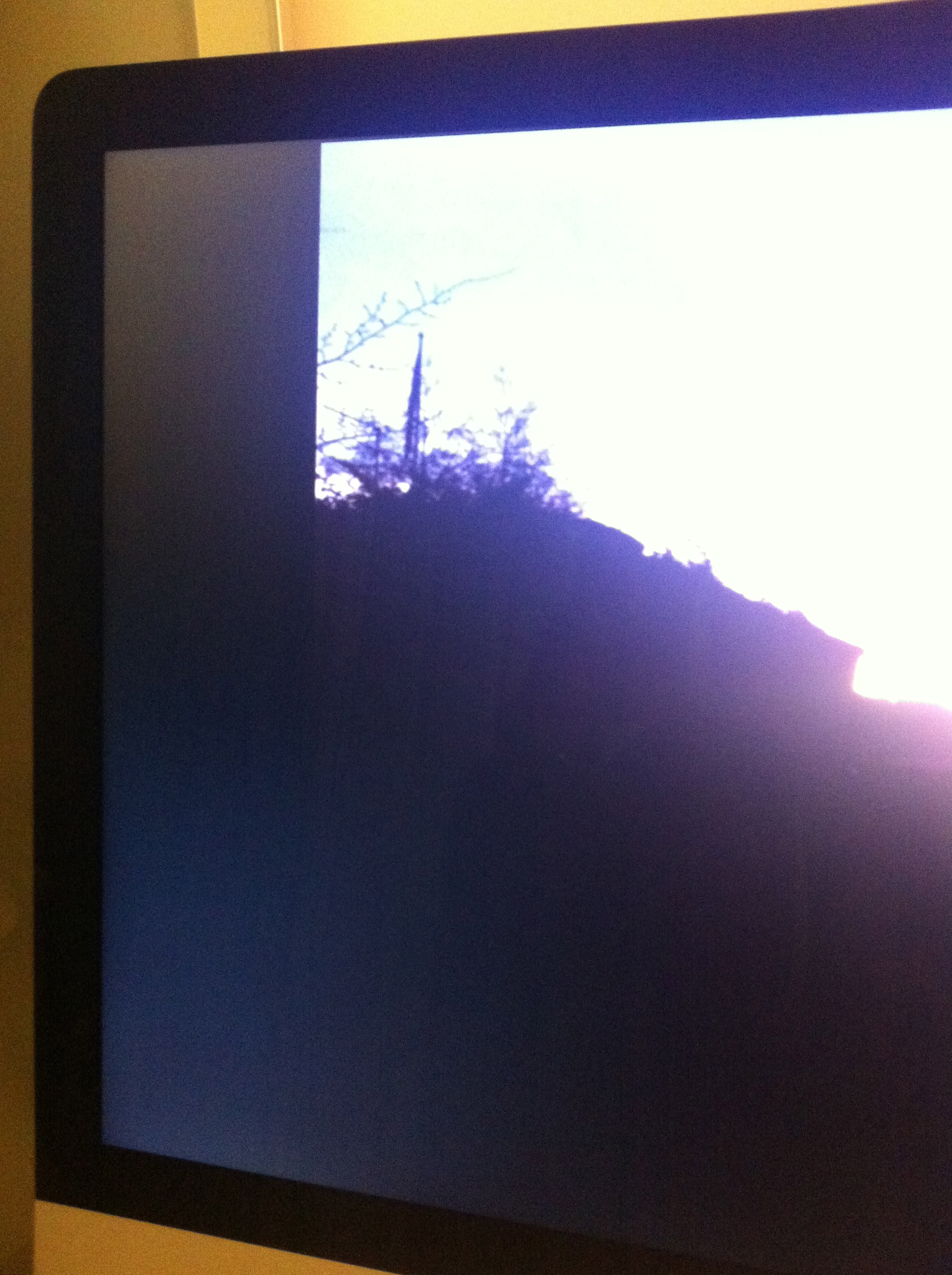

New 27" iMac - Display problem?

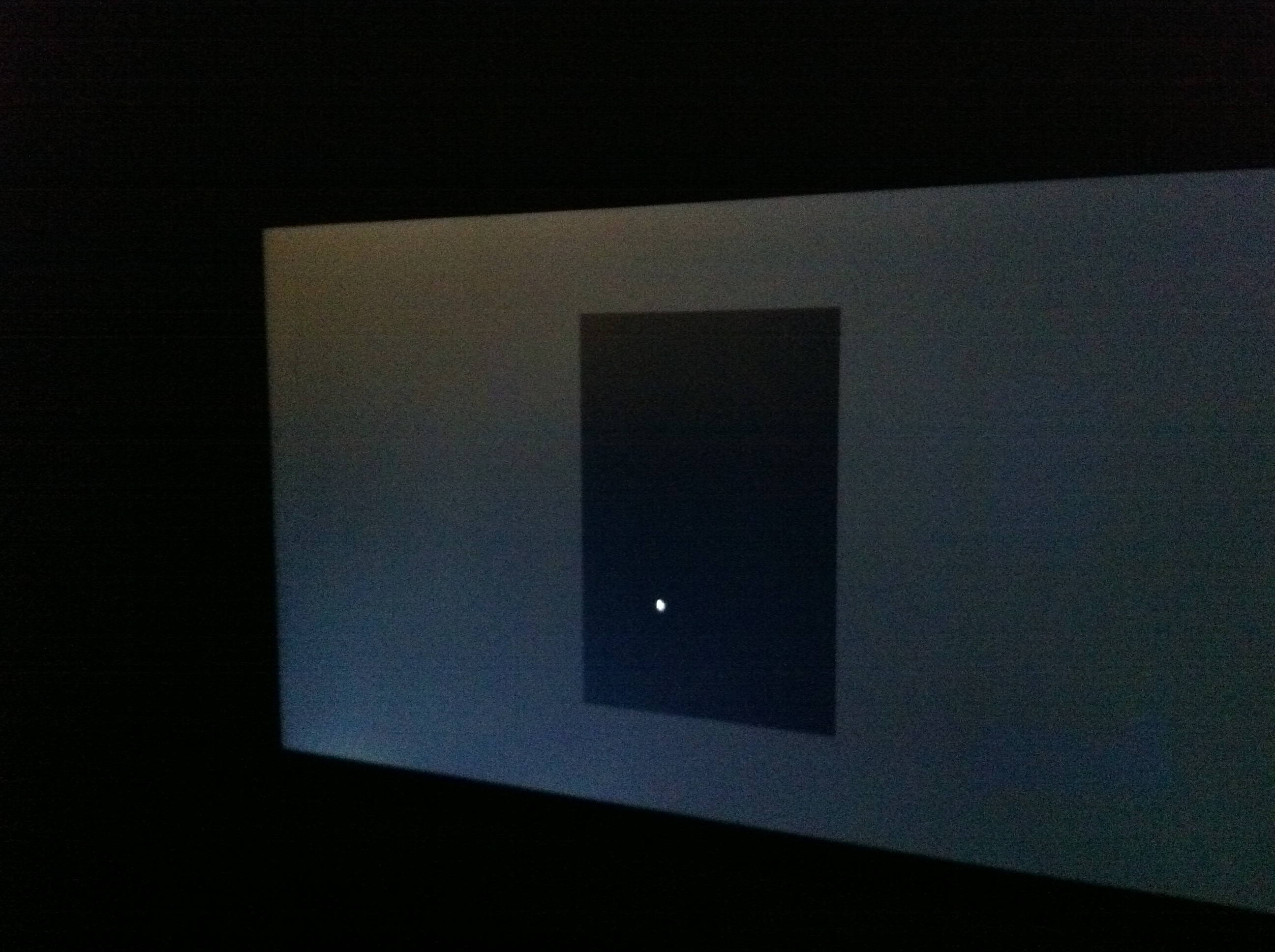

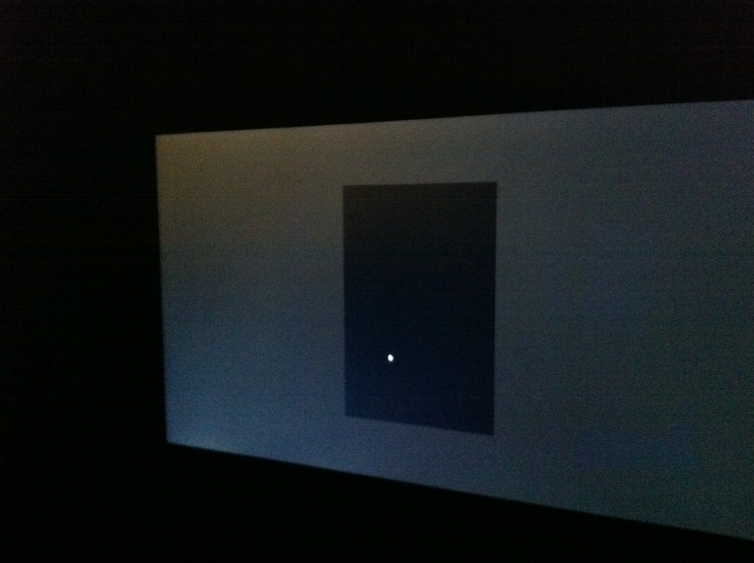

Hi All,
Do I have a display problem (27" BTO iMac with Fusion Drive)?
Set the background to Solid Colour - Dark Grey, open a dark photo in iPhoto which is 4/3 ratio. With my head about 12" from the screen, the top left corner of the screen has a bronze cast and the bottom corner of the screen has a blue cast (see attachment). 😱
When viewing images with coolish reds, again the bottom corner of the screen looks to have a bluish cast which disappears when you reduce the viewing angle to about 10-15 degres from dead centre viewing!
It is hardly noticable on the right-hand side of the monitor but really pronounced on the left-hand side of the screen.
Do you think it could be the screen coating or do you think I should look to get a replacement panel?

Hi All,
Dale, I do slightly see the "bronze cast" you speak of but it would be extremely helpful for all if you posted a picture of your screen with the blinds closed.

That is not light bleed, that's the limitation of the panel's viewing angles. See the post above for what light bleed actually looks like.

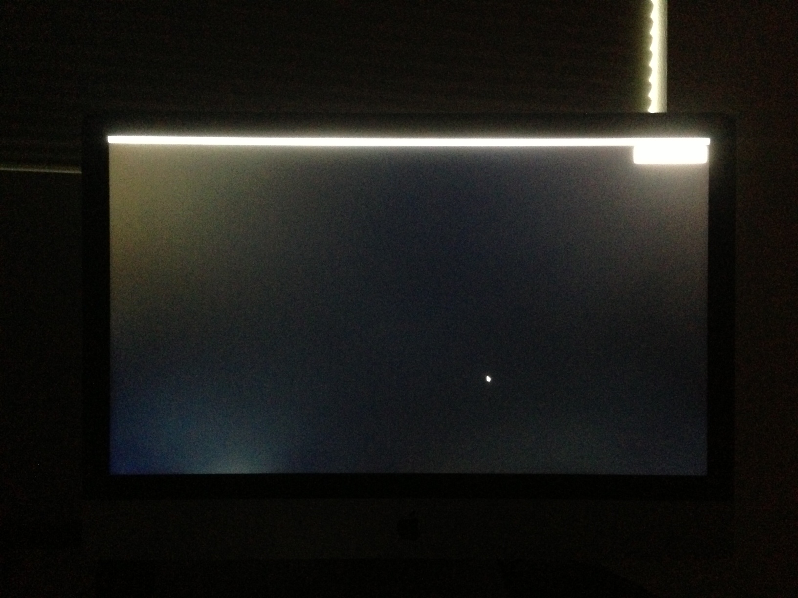

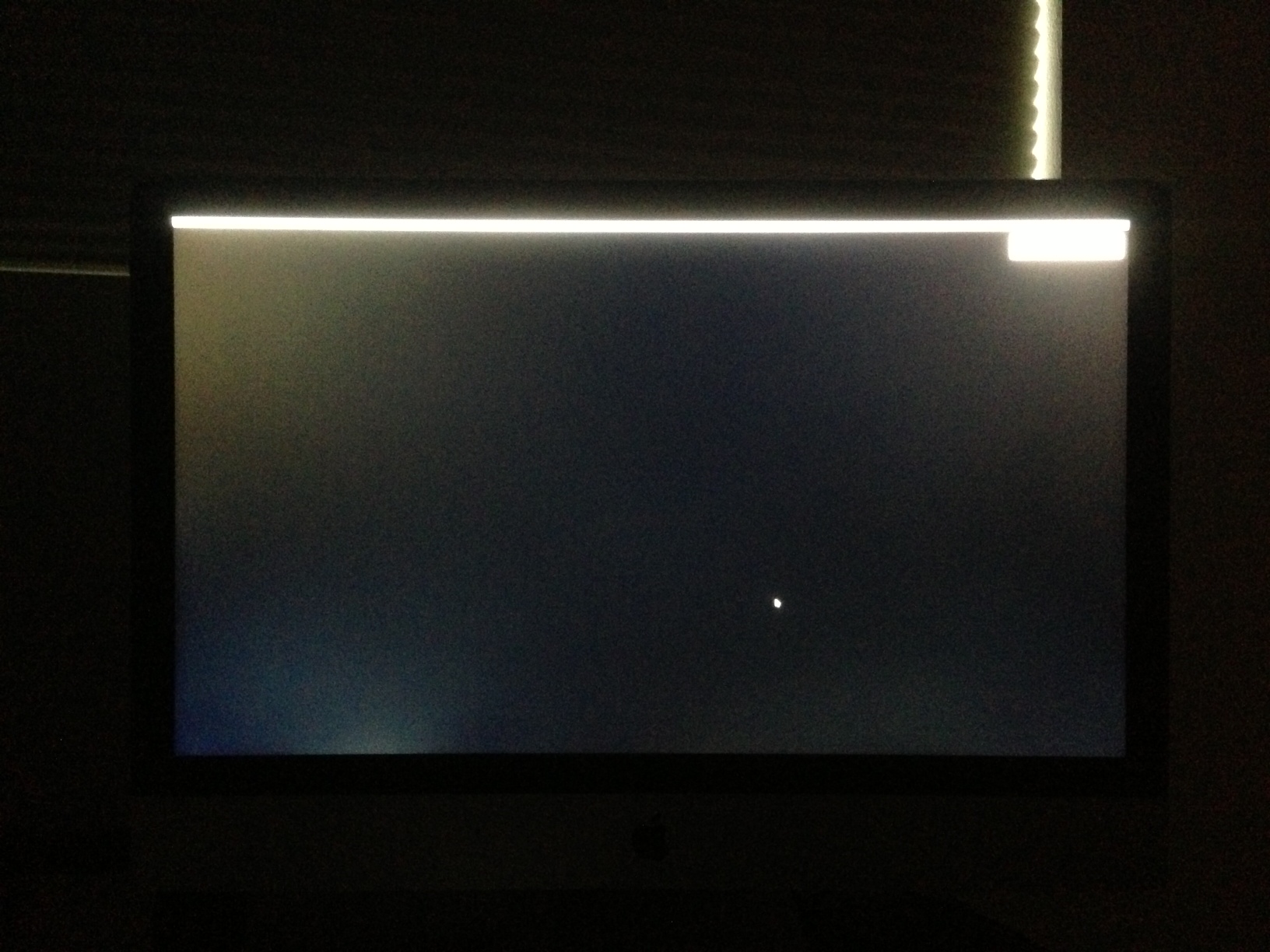

Bronze (and blue) screen cast with the lights out...
Thanks for a quick response HenryDJP. Here is another image taken with the lights out. The bright area you can see to the left of the monitor on the original image is a frosted acrylic panel, so hopefully this might eliminate any reflection of this.
Again, the desktop background is solid dark grey with a small very dark (black) image displayed in iPhoto (full screen).
Thanks Brian.
Would it be normal to have different viewing angle results on the right and left hand edge of the panel? On the left hand side, the blue haze is noticeable from about 15 degrees. On the right hand side of the display, you have to look from an angle greater than about 70 degrees to notice any colour shift.

Dale, that doesn't look good. While LCD's will show some oddities in terms of color uniformity it shouldn't be bronze-ish on one side like that. I would recommend that you take that back to Apple for a replacement iMac.
Thanks Henry. I am wondering if this is the screen coating. If I look at the iMac from below the desk, in the dark with the same dark image loaded in iPhoto, practically the whole screen goes bronze.
Do you think It could be the panels background lighting reflecting off the glass's anti-reflective coating?
It's normal. It's the viewing angles of the IPS display. If you sit right in front of that particular corner, the bronze will disappear.
You can see on one of my 2012 iMacs (replaced for the ridiculous bleed at the bottom) how the top left and right have that bronze look. They fade when sitting head on with that particular corner.

Thanks William. I feel a little better now knowing its just how these displays are.
