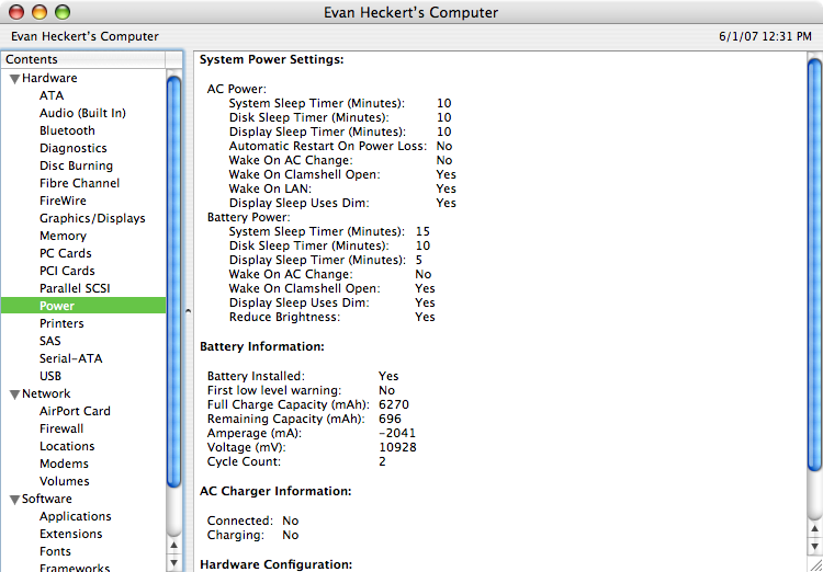

Can you post screen shots of its power information (top left Apple symbol/About this Mac/More Info/Power - command-shift-4, press space bar and select the info window), when both on and off A/C power?
If it's charging, the amperage entry should be positive. When on battery, it should be negative. If it's charged up, the full capacity entry should be about 5500 mAh
You did calibrate when you got it, didn't you? Which means it would have charged up once already.

Are you sure you have the correct on-battery image? They're identical and both say it's charging.
