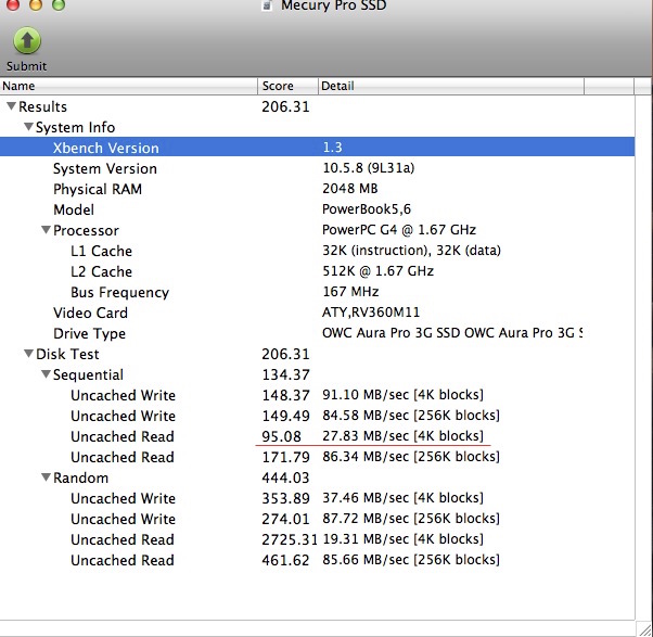

Xbench tells me that sequential read will hit about 92mb/s on an ATA100 bus(as in the later PBs) with the mSATA adapters I've been using. They pretty consistently have an overhead of about 8mb/s-I also get 58mb/s on an ATA66 bus. Of course, real world performance isn't quite that good, but it's miles ahead of what even a good(power sucking) 7200rpm 2.5" ATA drive will do.
Your estimate is very close, here is my PB with SSD XBench disk results.
I notice XBench is reporting a 167MHz bus for my unit.

The system bus speed is interesting but not all that surprising.
If yours is a non-DLSD, it uses PC-2700 RAM which is 167mhz. DLSDs use PC2-4200, which is 266 mhz. I haven't checked to see if the system bus actually reports at those speeds.

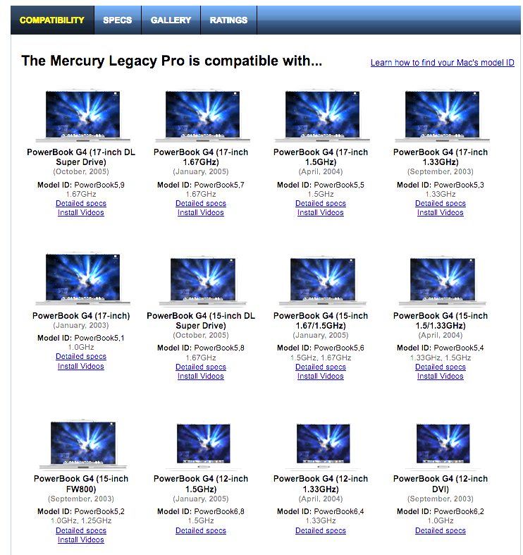

BTW, which compatibility list are you looking at? I just went back to their website and the Mercury Legacy Pro SSD does come up when I select my powerbook5,9 model from their "Select your mac by model ID" list.
http://eshop.macsales.com/shop/SSD/OWC

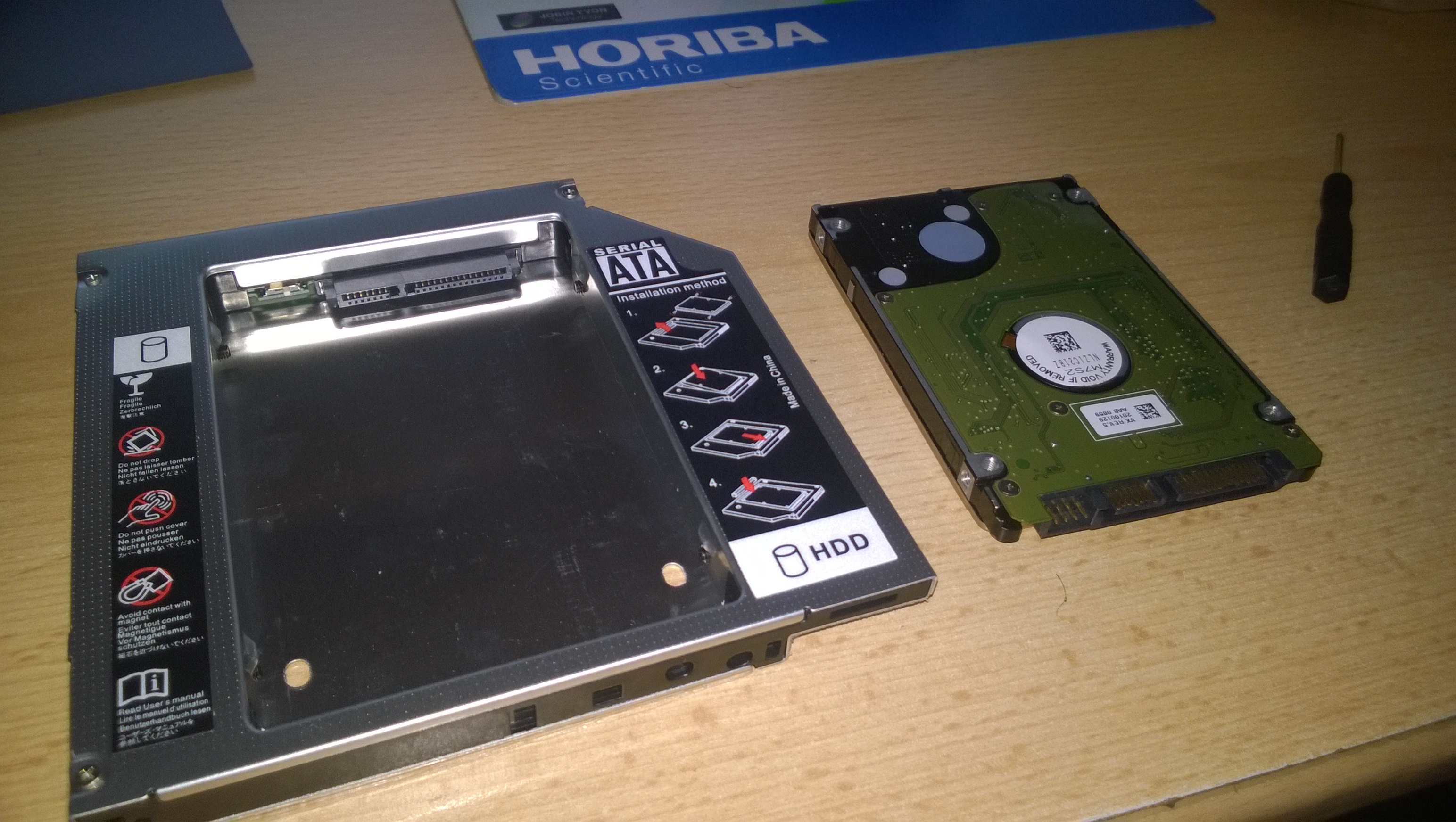

If you can forgo your optical drive, you can replace it with a SATA to ATAPI adapter to house a standard SATA SSD for storage, although performance will probably be lacking as I think the ATAPI port might be a bit slower than the HDD IDE port.
The list on this page from their website.
Looks like the PowerBook5,9 is the first one listed there.
