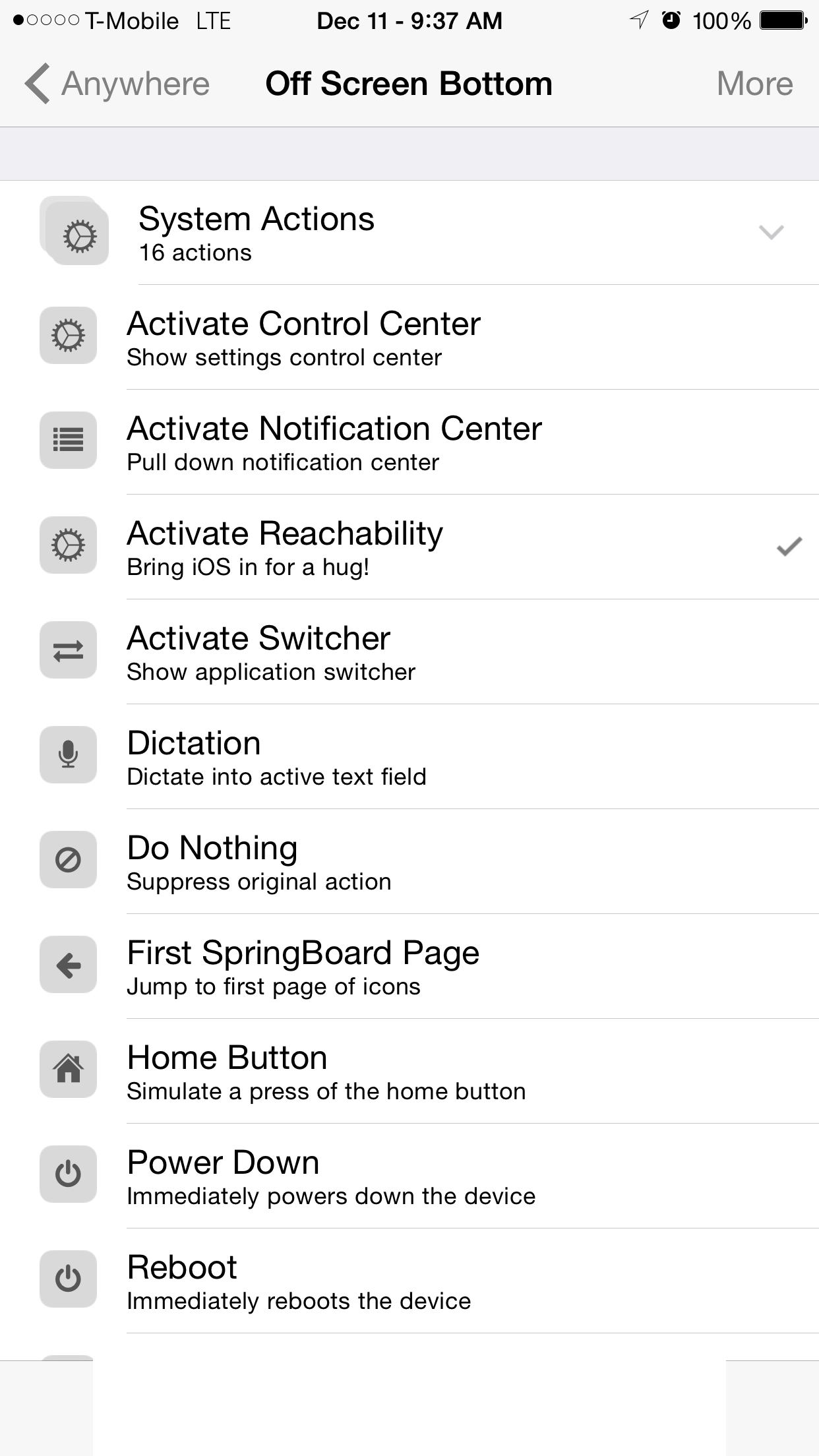

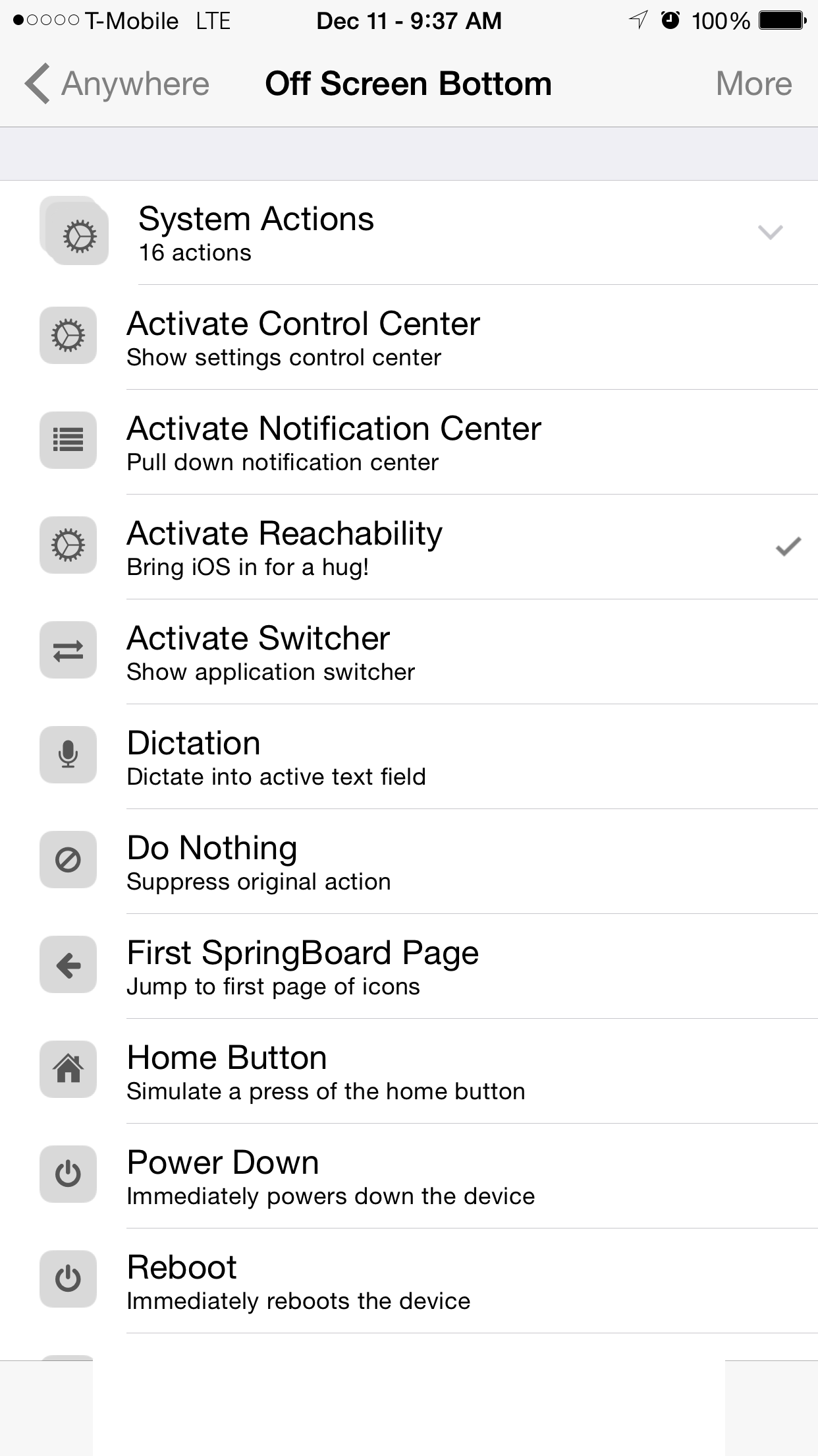

I can't find reachability inside activator, can someone advise where it is so I can reading it. Thanks
here is the screenshot.
