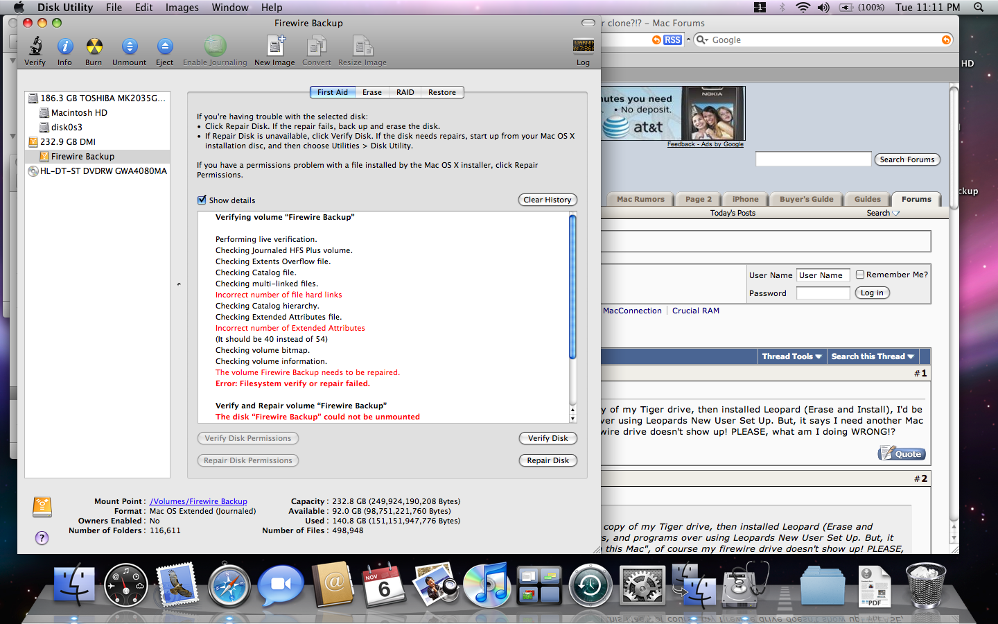

Thanks BobZune. So I think I may have found my problem....I opened up Disk Utility and ran a verification and attempted repair on my external Firewire Tiger backup, and I got what is in the picture below. What's weird is that its still letting me copy stuff off the Firewire backup and it lets me boot into it fine (albeit slow). With what disk utility is telling me, what would you guys suggest I do if I still wanna go the Migration Assistant route?

... With what disk utility is telling me, what would you guys suggest I do if I still wanna go the Migration Assistant route?
Did you boot from firewire drive and do the verify with the Tiger version of disk utilities? Does it tell you any different?

I am tempted to say bring back the information from back up using the Migration Assistant (if you managed to mount it), then do a permissions repair and see if everything came in "right." If not, you can pursue the other options.

Sorry i didn't update you with how this went Bobzune. I just decided to manually move everything back over since I did not wanna risk cloning back and forth and corrupting my data somehow....Thanks so much for the response tho man. It was really helpful.
