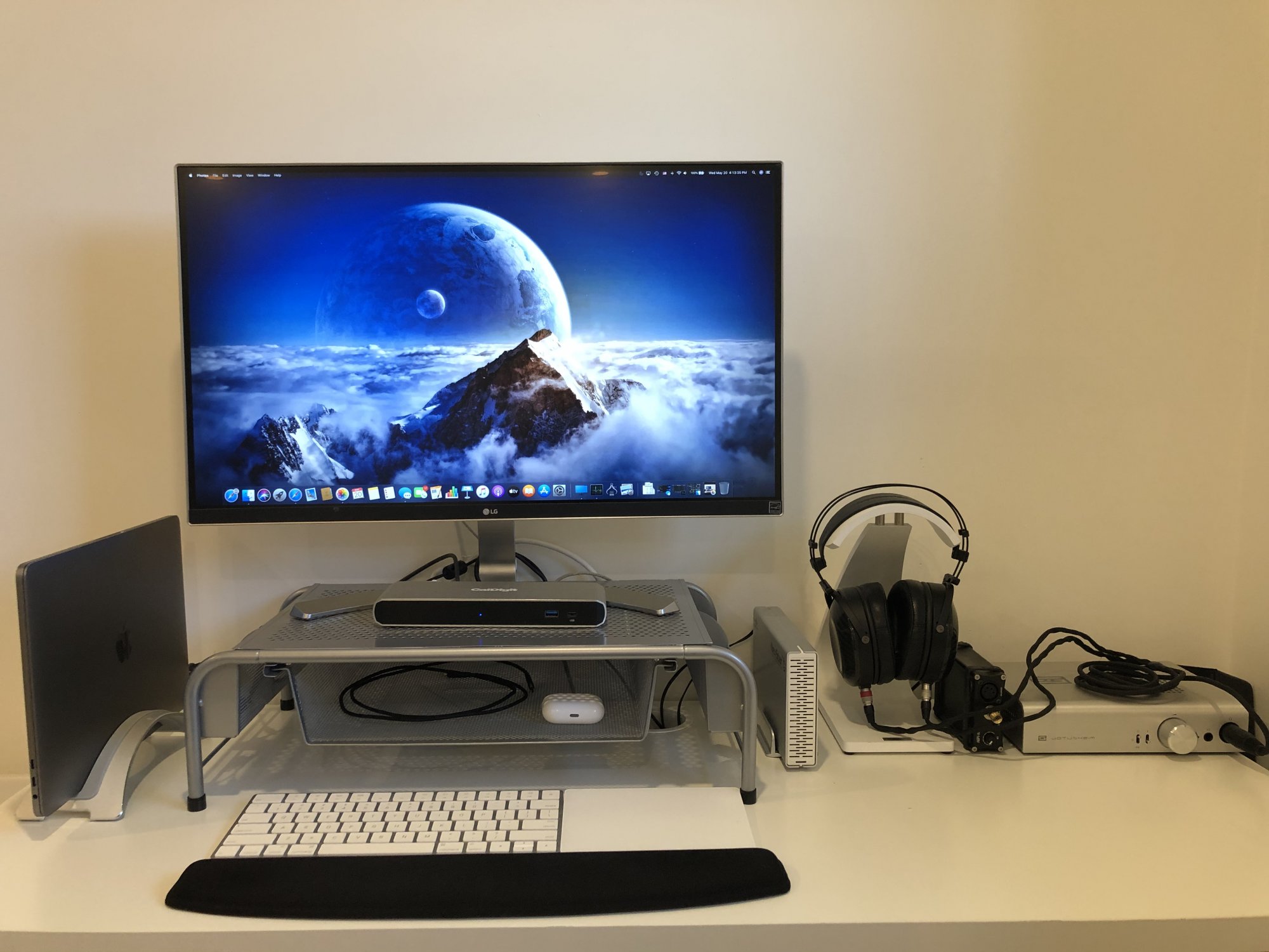

Here's my small desk setup that I've been working from home with for the last year during COVID - I went from using this setup occasionally on weekends, to full-time WFH use, and have been really happy with it.
Nothing too crazy - the monitor is a 27" LG 4K (27UD68P), a great bang-for-your-buck monitor, and the dock was one of the first Thunderbolt 3 docks that came out in early 2017 when Apple debuted the late-2016 MBP (Caldigit TS3 Lite, which they don't make anymore, but was great for my needs).
awesome set up! quick question, I'm using the same monitor as you but I can't get 60hz. I'm using this dock
and connecting it with an HDMI cable. I can't get more than 30Hz, any ideas?
So I remember there were issues with this monitor running 60Hz over HDMI. I use it over Displayport, and while I still occasionally have 30/60Hz issues using my dock (where I have to turn everything on in the right order), I can get it to 60hz consistently following the procedure.
Assuming you're sure that your HDMI cable is 4K@60Hz capable, check that you've enabled Deep Color Mode in the monitor settings. The default for that is off, and it has to be enabled for 4K@60Hz over HDMI.
