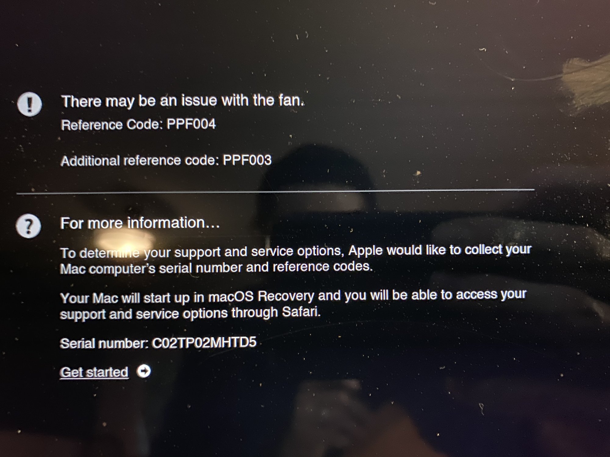

Ran diagnostics and got this. Anyone know these codes and what it means?

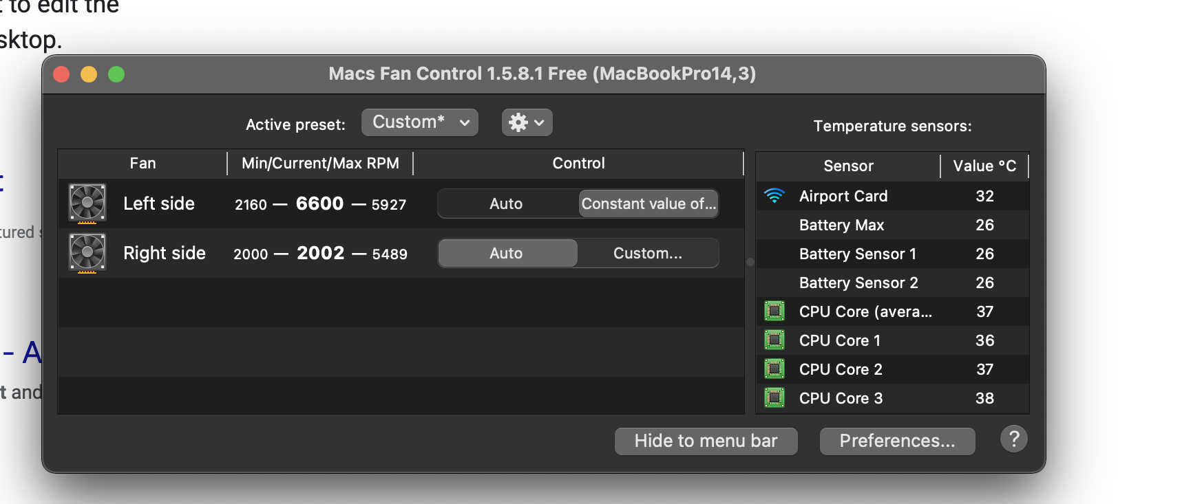

I remember replacing a hard drive on my iMac years ago and the fans going full blast. I used the Macs Fan Control to auto adjust the speed.
I downloaded it and it looked promising, but its not able to change the left fan to match the right, even tho there is now a custom setting on it
