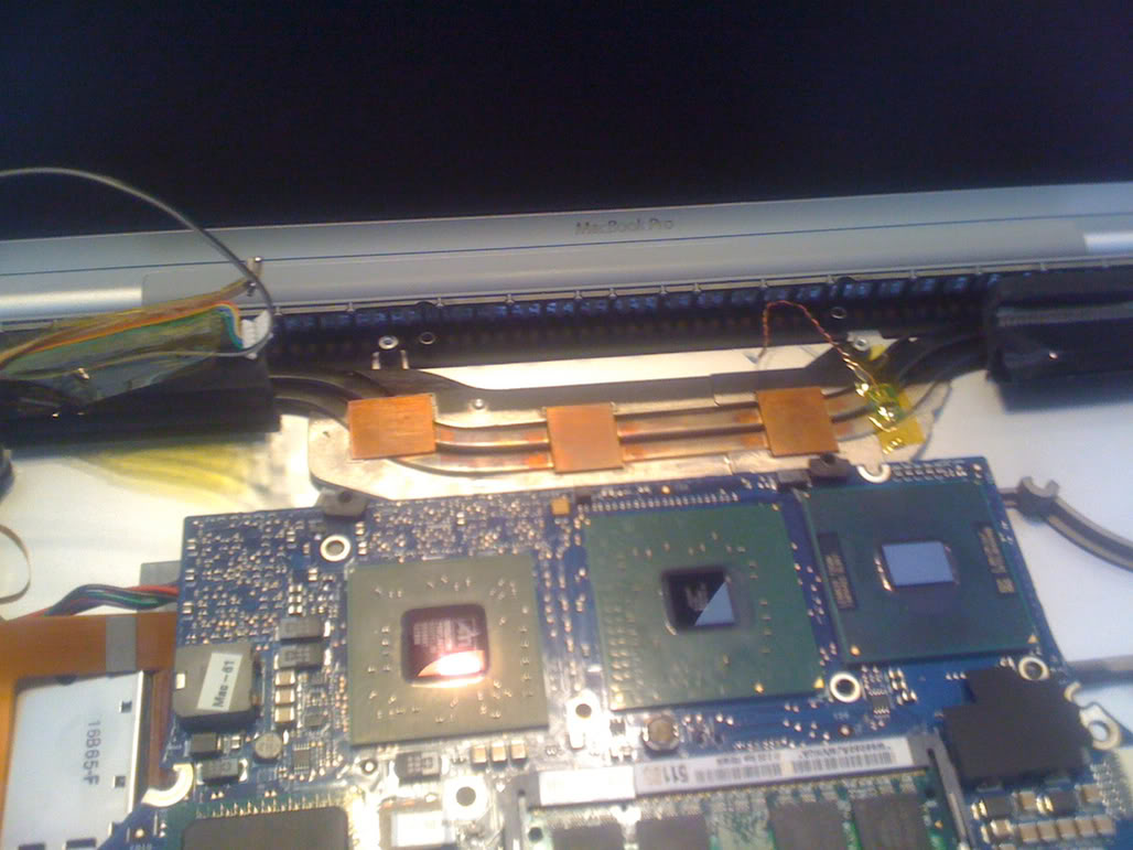

Well my MBP seems to have been running a tad bit warm. Took it apart and this is why. I've read all over the internet that Apple always seems to do a crappy job with applying way too much thermal paste to their processors/GPUs.
Pictures below confirms this and now my MBP is running 10-15*F cooler. Fans stays at a constant 1000RPMs. I haven't used SMC Fan Control yet to increase them as now I don't have to but maybe I will increase 500RPMs or so but I like how quiet it is now 🙂.
Cleaned them off with q-tips and 90% alcohol and applied Arctic Silver 5 thermal compound.
Yuck what a crappy and sloppy job. I removed chunks of the old stuff.
All clean now. Look how shiny them chips are 🙂
