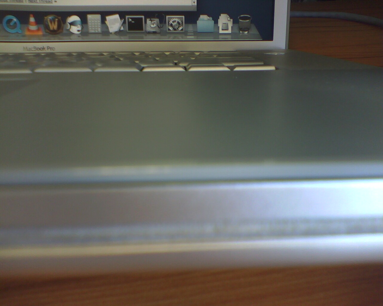

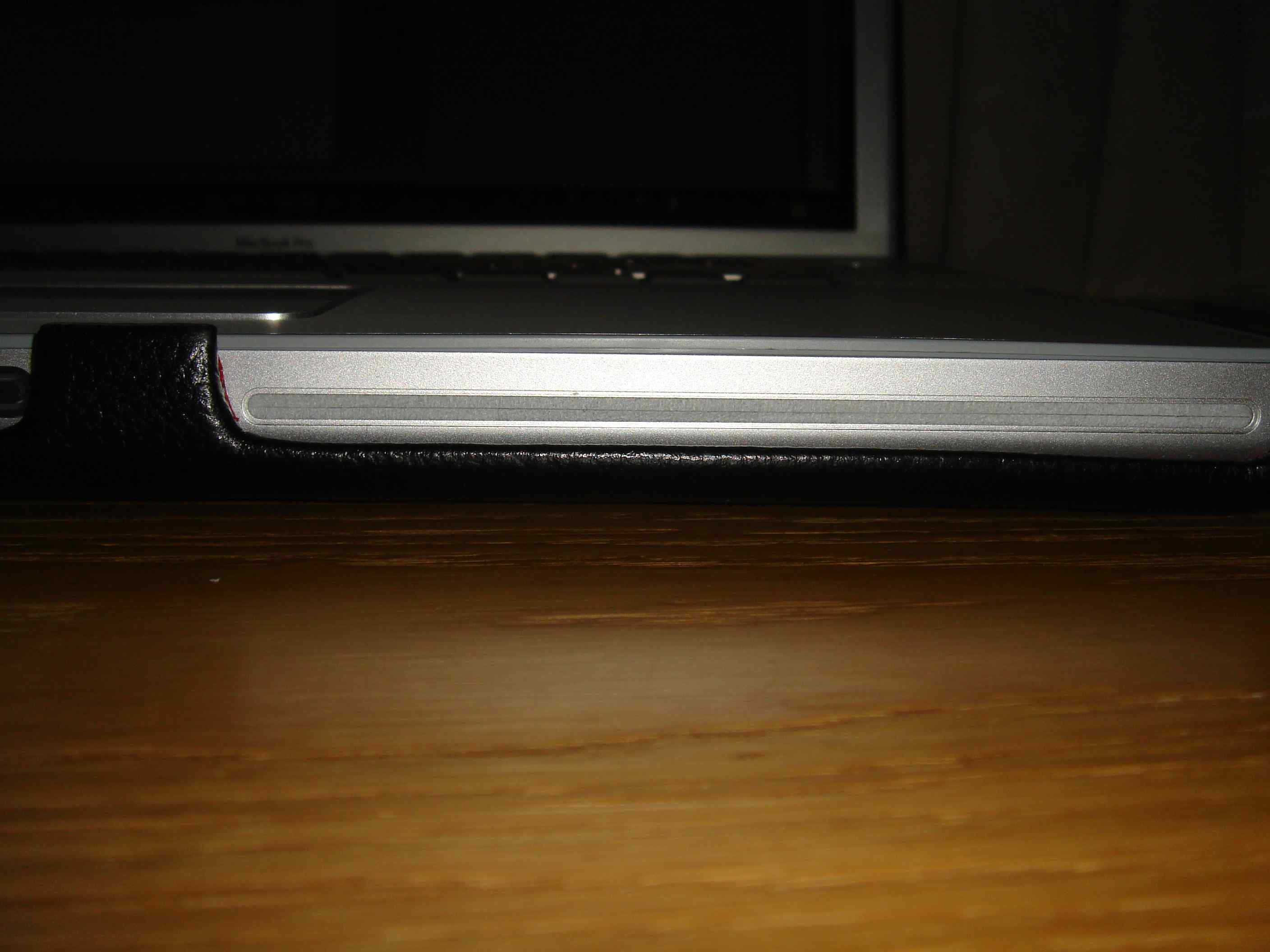

MacDann

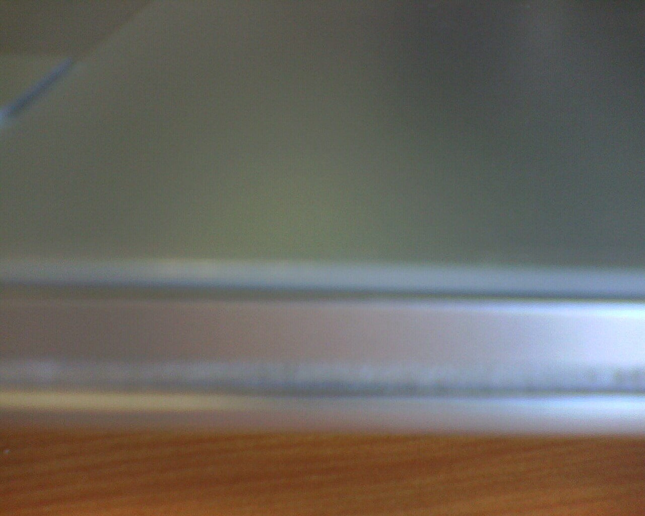

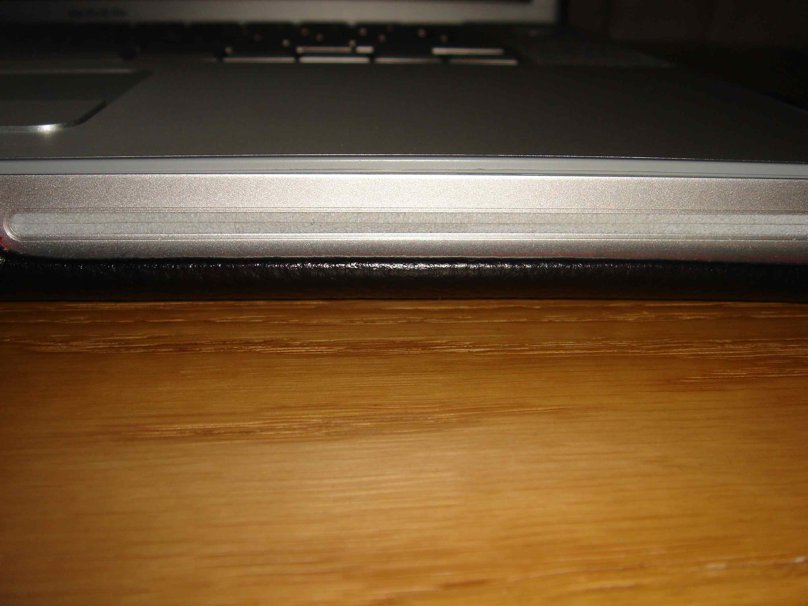

I apologise for the poor quality pictures, they're from my cellphone, but you can still see the gap.
Could it be...
Could it be that you have "bent" the Aluminum beyond it's bending point...?? Technically called Plastic Deformation.. (Elastic Deformation means it bends but not so much it can't be returned to Original shape... kind of like a Car dent that can be "popped out" instead of Body Shop work...)
I have seen posts where "HD replacers" have suggested "stuffing the DVD Slot with some items to fill so that the snapping down of Top Lid to make the Clips hold will NOT bend the small Aluminum piece downward... this is likely what has happened I think!! 🙁

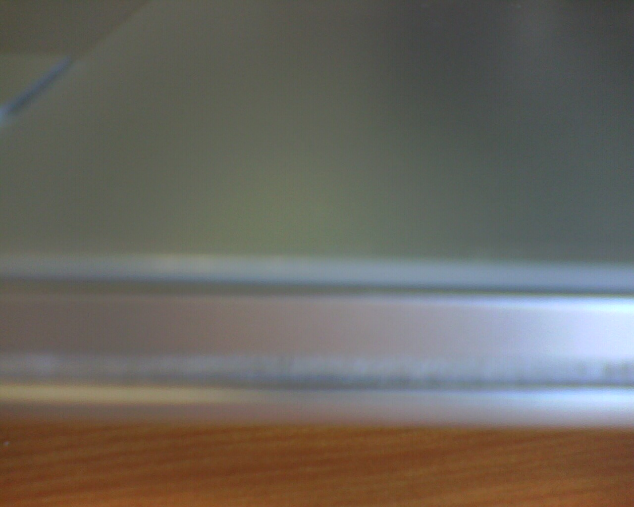

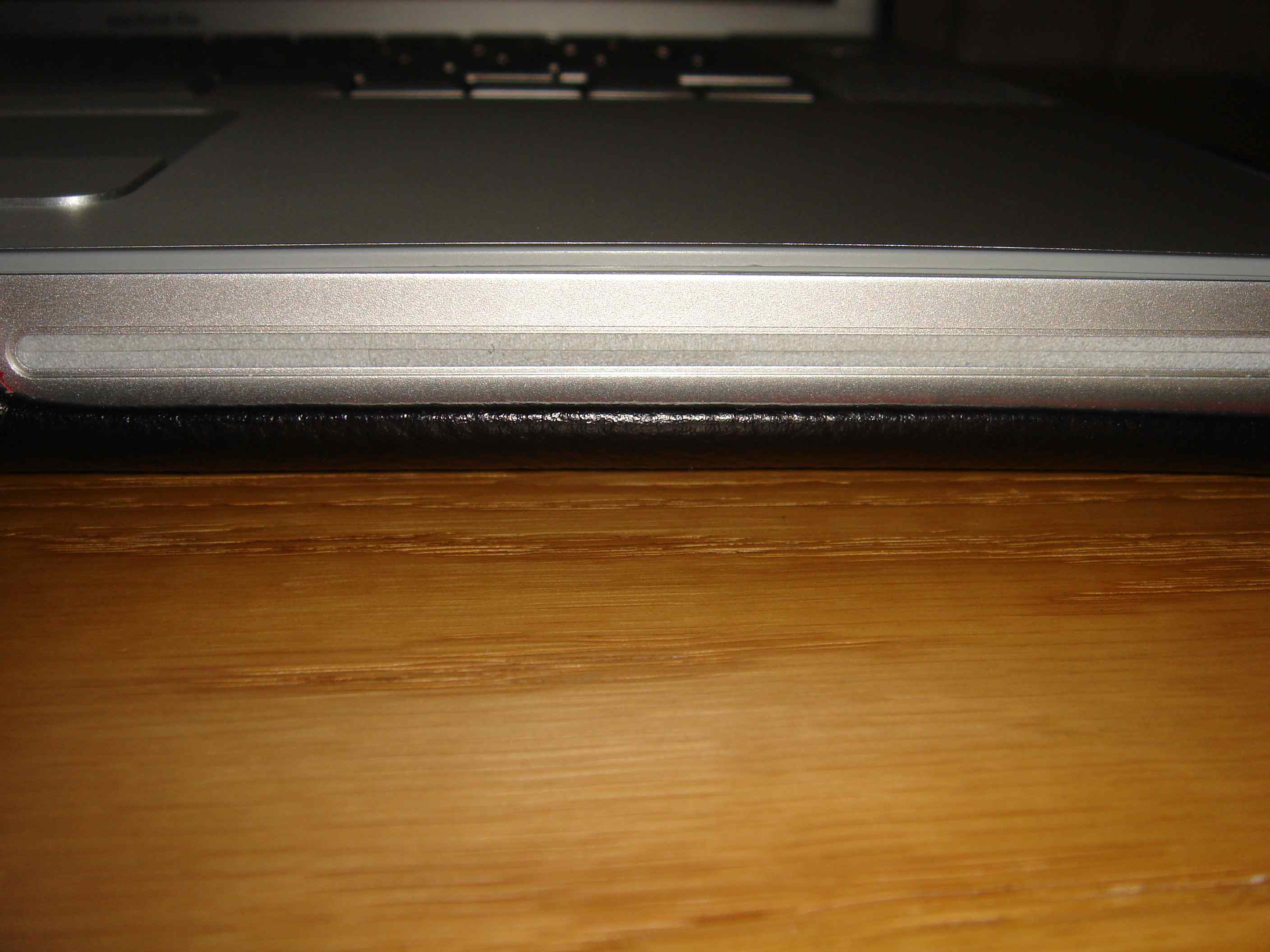

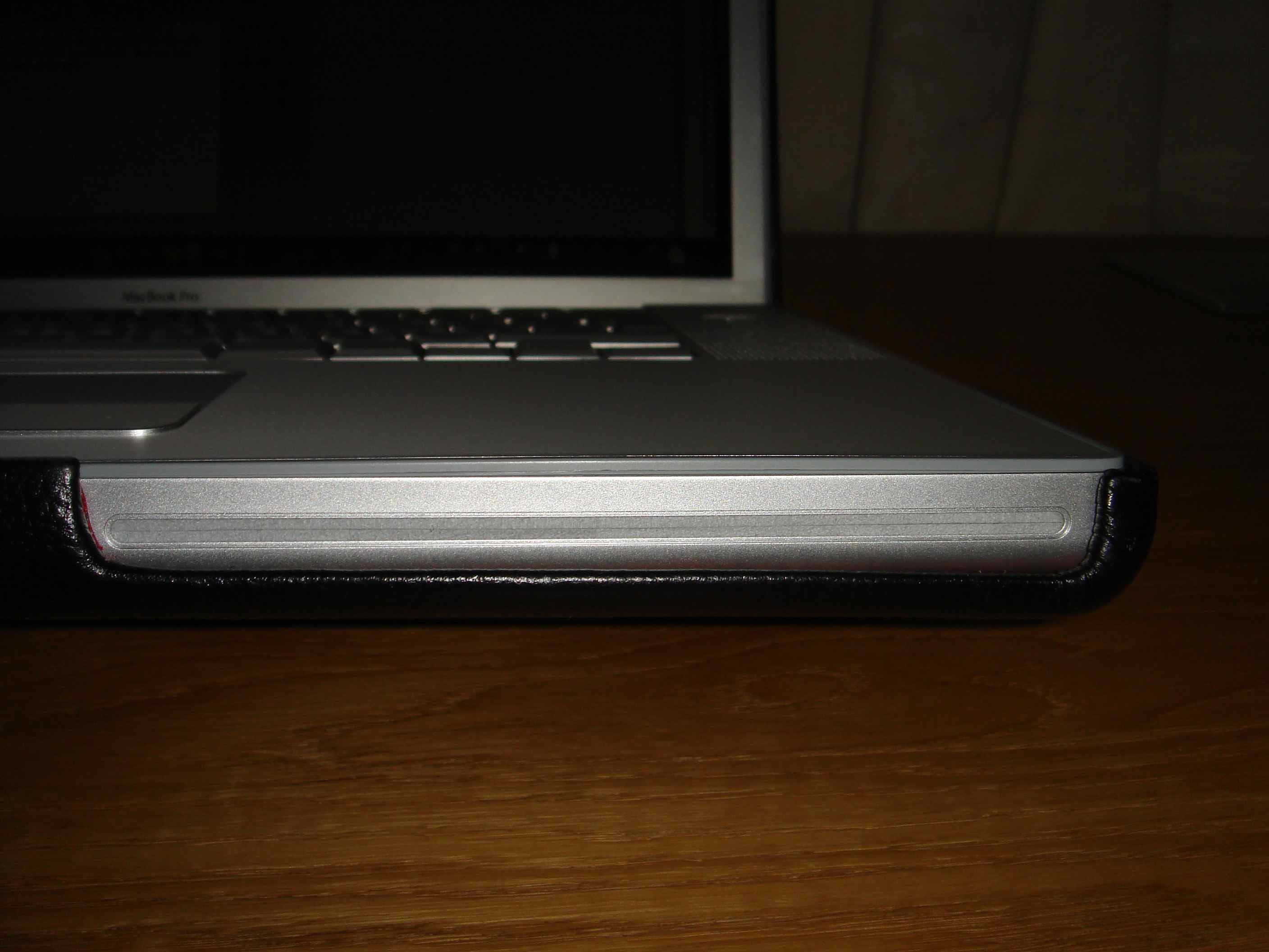

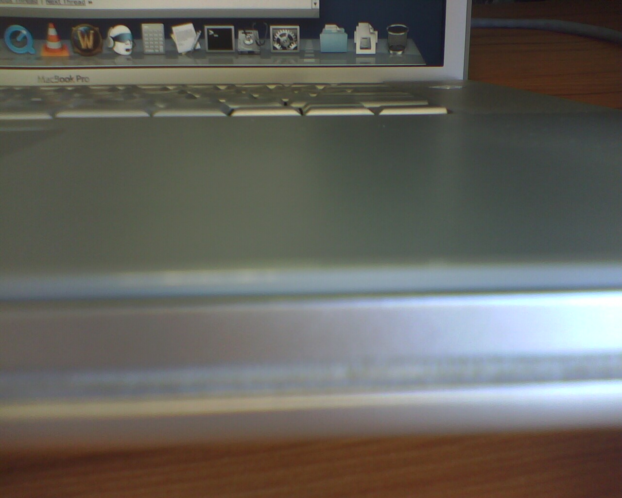

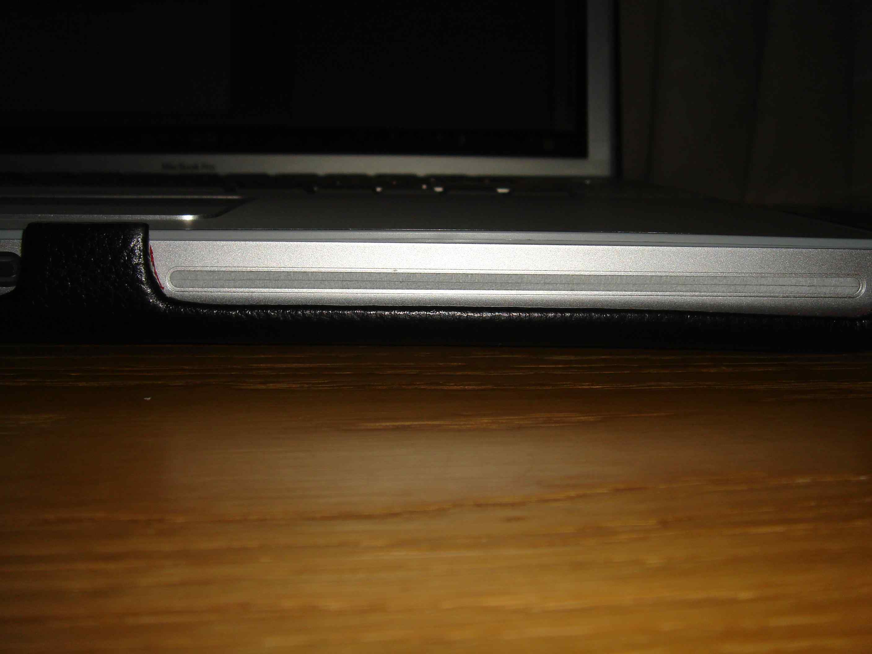

I have opened up both my macbook pro's 15" and they both did that, I reopened and everything clicks in place around the case, except for the left hand side. I tried pushing harder on one machine as advised. But no joy. Here are some close up macro shots to demonstrate.
