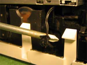

    the sensor is in the lower right-hand portion of this picture
    [​IMG]
    Right here:
    [​IMG]
    If you forget to connect it, the fans will run full blast. that is the most common mistake in upgrading the mac mini.
