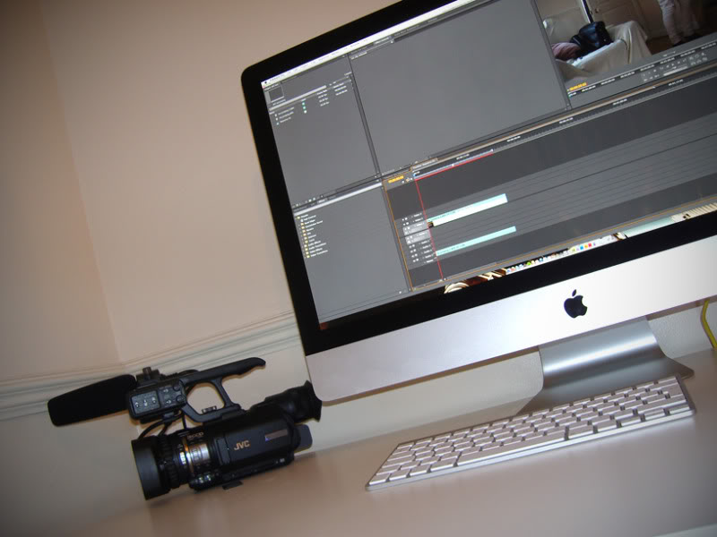

The phrase "all the gear no idea" comes to mind here. So ive got a JVC GY-HM100 provided by my Uni & premiere pro on my new 27" iMac, unfortunately no FCP though. Im planning to shoot in 720p/50p because I want to slow the footage down for some smooth slow-motion.
What is the best way to achieve this?
Do I want a 25fps timeline or a 50fps timeline?
What will be the correct project settings, i.e HDV, XDCAM, AVCHD etc?
Should I use Adobe media encoder to convert the 50fps clips down to 25fps?
Or should I just slow the clips down using 'speed/duration' in Premiere Pro
Il be shooting a BMX video at a skatepark during the day & floodlit at night, how do you think it will cope under the floodlights?
So many questions but if one or two can get answered I will be more on my way to a good end result. Im much more of a graphic designer than a video producer so im right out of my comfort zone now. Il post a link to the video when im done.
Thanks in advance.

imac 27 with jvc hm100
how does the imac 27 run with full resoution gyhm100 footage? Is it fast enough?
how do you get premiere pro to open gy-hm100 footage?? i am having some serious issues, the only footage ive been able to watch came on my girlfriends macbook where she has FCP 7... 😕
sounds like you have shot the footage in the quicktime format, as far as I am aware the footage is ONLY compatible with FCP. to edit in Premiere you need to shoot in mp4. You may be able to convert your footage using media encoder or compressor etc.
