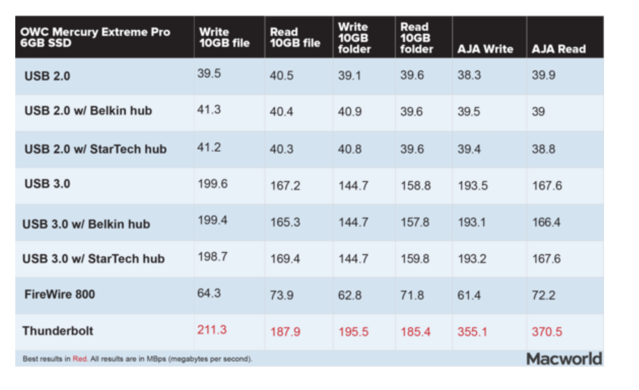

I have a mid 2011 iMac with only usb 2 so got the above adapter to add usb3. I've attached a Sammy 850 evo 250Gb to it via a sabrent usb3 to sata adapter (same drive as I've added internally). Running Aja system test and black magic I'm only getting 355MB/s read and write, from external yet get approx 500MB/s from the internal drive. Should there be this much difference between the 2 interfaces, using identical drives?
Theoretical maximum for USB 3.0 is around 600mbps. Now there's a lot of overhead and whatnot to consider, but you do seem to fall well below that. Then on the other hand (see attached image) this is a test done by MacWorld, and there can be quite a difference between using Thunderbolt/PCIe and USB.
Does the USB-SATA adapter you use support UASP? macOS does not right now as far as I've been able to gather, but the connectors that support it are also usually just a lot faster than those who don't.

Thanks for reply. Yes adapter does support uasp. Supposed to be optimised for SSD. Thing is it is constant 355MB/s read and write with no fluctuations, as though it's topped out at the adapter(either the sata or the kanex) or it could just be I'm going through 2 adapters.
Definitely sounds like there's a bottleneck somewhere, though I don't know where it is.

On a Mac with native USB3, the "max" for an SSD connected via USB3 (with an adapter that supports UASP) is about 432mbps. I have never seen a report of one running faster.
Considering that you're factoring into the mix ANOTHER "converter" of sorts (the Kanex adapter), I'd say you're getting about all you're going to get... 😉

Yep figure so, not complaining thats plenty fast enough, just curious as to why such a big difference with the same drive internal.
