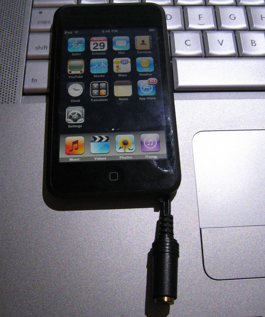

Well, I fixed it. I gave up on trying to fix the built-in jack, so I just soldered a new headphone jack on. There are 4 solder points next to the built-in jack, from the top they are switch, left, right, and ground. The switch pin tells the iPod if headphones are plugged in. It is low (floating) when there are no headphones and about 1.6V when they are plugged in. I don't know where the 1.6V comes from, so I just stuck a piece of plastic in the old headphone jack to make the ipod think there are headphones plugged in. The new jack sticks out the bottom. I Dremeled out a hole for it, and even though the case doesn't completely close in that corner, it looks OK. I can still use the original headphone jack for karaoke if I pull the plastic out.

Just an update... the headphone jack I soldered on finally broke. The edge of the case cut into the wire, and it finally came off completely. It lasted 7 months, which is not bad for a quick fix that I expected to last maybe a month. Audio still works using my USB+line out dock cable, so I can listen to music in my car (while it charges, too). Maybe I can hack something that connects to the dock line out lines and allows for volume control for headphones.
