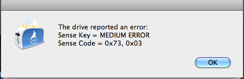

I have been getting this error whenever I try to burn a disc through Toast:
I don't understand why, could it be due to how old the discs are possibly? After I receive that error, it shows up 4 more times, and then it says writing lead out, and now i can't use the discs anymore. I then try popping it back into the drive, and try to open it up in Finder, and it says i don't have permission for this task which makes absolutely no sense. I have tried making a DMG of the files I want to burn through Toast and that works, but I go into Disk Utility to burn it, and it says the disc isn't supported by my drive. Now I have been having issues with CDs as well, where when i burn a music disc through Toast and iTunes, random songs throughout the disc have static at higher frequencies in the song.
So what could be the problem?

You can't reuse a disc that's had a failed burn, so just throw them out or use them as coasters.
Medium error means that there's a problem with the media. Try different discs. Age could certainly be a factor.
It does seem as tho the "superdrive" can be a bit twitchy with regard to which discs it will write to.
I am using toast with brand new TDK media and having no problems but some older unbranded discs which work fine on my PC are no-go on my Mac.
Medium Burn error cd burning problem -maybe fixed?
Suddenly my macbook pro started giving me that message medium burn error most of the time when I went to burn a music cd. I tried different brands which didnt make much difference. Then I tried burning at a lower rate of speed instead of max speed and this seemed to fix the problem.
