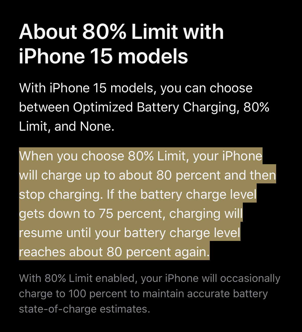

Come across this from Apple. Sounds like it will only start charging again once the battery drops to 75%, rather than a constant trickle charge keeping it at 80%?
My assumption always was that if you keep your phone or MacBook for that matter plugged in at the 80% threshold, it basically operates straight from the power outlets power source, passing through the battery without actually using it. I doubt it constantly charges between 79% and 80% to keep it always at 80%. Sort of like a tv that only works plugged in and has no battery?

Also FYI what I've also noticed is it does not trickle charge all the time to keep at exactly 80%. Once its there it will stop charging unless it drops to a certain percentage or when you unplug & re-plug the phone for it to restart the charging back to the maximum 80%/mAh. Seems like Apple's battery management is pretty good so definitely no need to worry about it degrading your battery leaving it plugged in all the time.

Brilliant thank you. That’s what I was thinking and what Apple states, once it reaches 80% it will stop charging and resume again when it gets to around 75%. So not on constant trickle charge. They really have improved BMS on the latest iPhones, and they’re rated to retain 80% capacity after 1000 cycles.

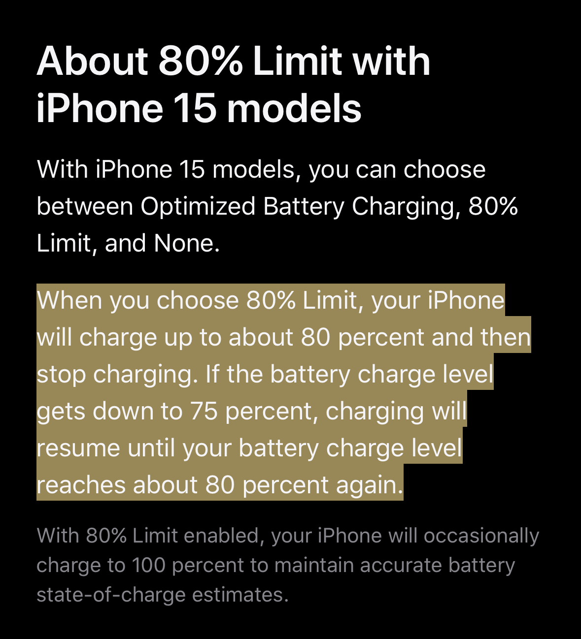

By the way, this behavior is the same for 100%. That is, when the battery state-of-charge reaches 100%, it will stop charging until the level is at ~95%, resume charging, and continue this cycle until disconnected from an external power source.
Another FYI: This small ‘maintenance’ cycle isn’t displayed to the user — well, mostly. In other words, the charge percentage indicator(s) will remain at 100% when the 95-100% (or 75-80%) cycle is occurring. However, for example, if the device has reached 98% in this cycle, you disconnect from the charger and begin using, you might notice the battery charge percentage display(s) jump from 100% to 97%. You may also see the true charging behavior in apps such as coconutBattery.
