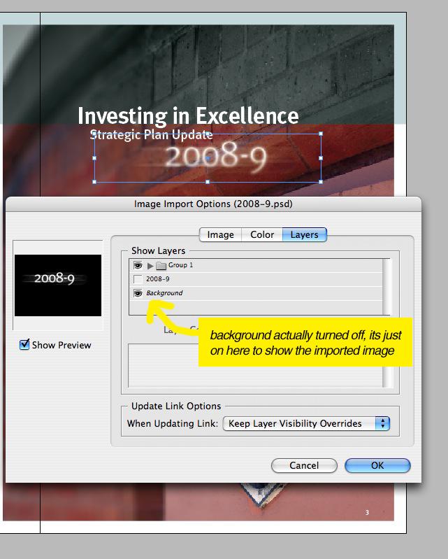

Has anyone had any experience importing layered psd's into InDesign before? I've always done "fancy" text effects directly in Photoshop but now need to combine this with straight InDesign pages.
It all seems to work fine (as you can see from the screen shot) but when you export this as a pdf, you get a hairline white box round it when viewed in Preview or Acrobat.

This is due to the PDF compatibility. When exporting, make sure that the 'Compatibility' is set to at least 'Acrobat 6 (PDF 1.5)'.
This should get rid of the white lines

i think some of you missed exactly what i meant though. the psd has multiple effects on the type though. in this case, blur, motion blur, a mask.
the type is white, and i'm working on a black background just so i can see what is what.
i want to import only the text effect layers. in other words there is no chance i can flatten this as it'll appear with a black box.
my query is whether anyone has left the layered psd's in InDesign, WITH LAYERS TURNED OFF when making the pdf. i always leave my tiff's unflattened, but i've always used all the layers.
