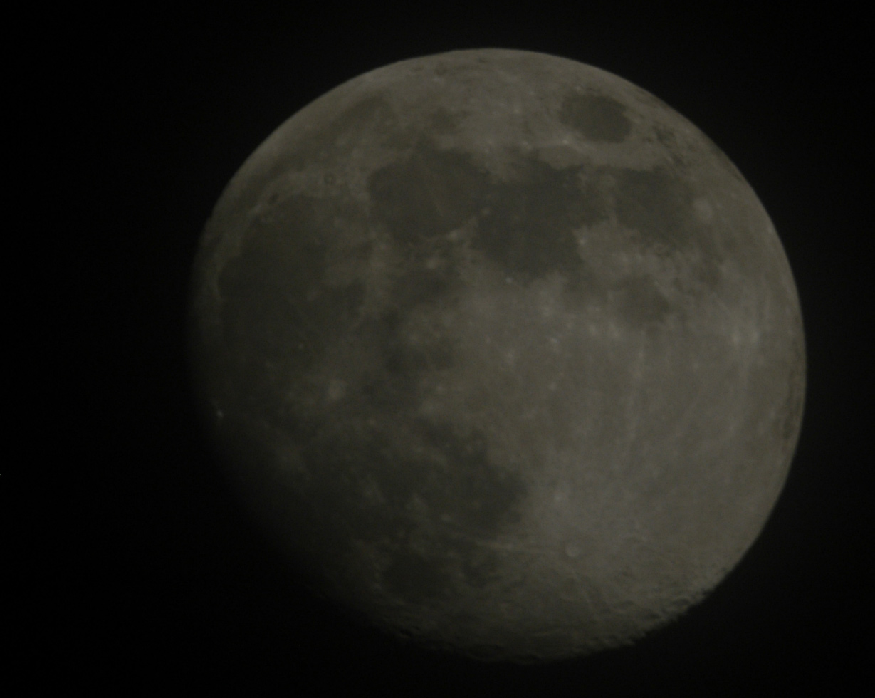

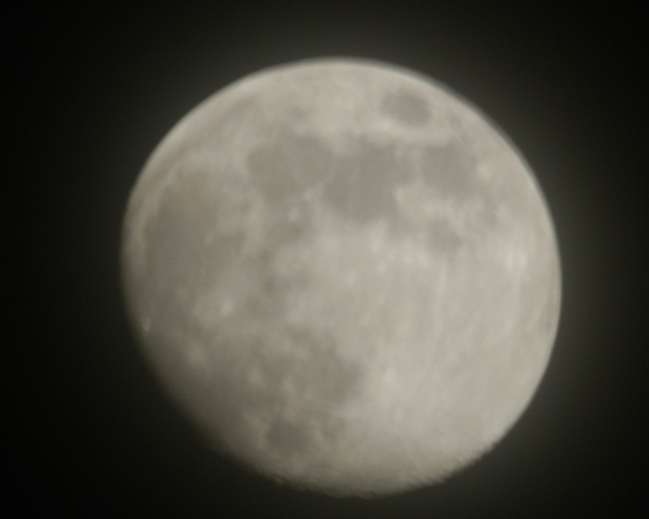

Well... the D100 and the lens aren't mine, they belong to my dad. I, personally, use a Coolpix 8800 but yeah now I wish I had bought the D50. The lens is quite old, I think he used it with his F3 or F4. And so I don't know really know about the lens' resolution but I've attached 2 pictures. One taken at 1/125th and the other at 1/30, maybe you can tell if the lens is good or not? I don't know much about tele-converters either, do they make a lens resolution worse?

The 125th sec. one looks like it's not suffering from "mirror slap" to me. It looks more like the softness is due to the 500mm reflex lense + teleconverter combo.
Try boosting the ISO higher to get a higher shutter speed and a bit more exposure (maybe 250th and ISO x4). Also try removing the teleconverter; you may get better results.
I tried photographing the moon with a 500mm reflex. I wasn't pleased with the results. The 500mm went to eBay.
I'm not sure here, but maybe we're seeing blooming on the second image. By using brightness and contrast I can make the second image a lot brighter/usable. You should try the same thing, maybe try a shot at say 1/100 and see if you can't improve apon this. I would NOT raise the ISO. The images you showed are already a little noise, and I think it will only get worse if you start boosting it, as it is the D100 can't shoot less than ISO 200. I think with the various suggestions here (D100's mirror lockup can be found under Custom Function 24 and causes the mirror to lock up 1/2 second before shutter opens) you'll probably catch a few good images that can be made better in post.
Might as well take every combination you can think of, 1/125-1/30, and see which ones are usable, and then take off the TC and see if things are better. I wager they won't be, simply because even though resolution goes down when using TC's its generally still better than cropping.
It's savable, although the noise produced from bringing up the exposure isn't so desirable.
Do what Jared said and keep trying different combinations. 🙂

Our meathods must differ a little bit, mine didn't get that much shadow noise. Never the less, maybe running it through some noise ninja would work (I cannot I don't have it on this computer at the moment).
