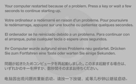

FYI, this is what a kernel panic looks like. If you didn't see one of these two images on your screen, then it likely wasn't a kernel panic:
