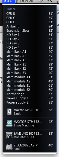

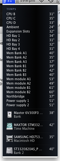

Here is my temps attached in the pic
I just read your sig. That over clocker from zdnet screws with your system. Either back it down or remove it. I'll be that's were your getting your kernal panics from. I tried it once and removed it. Couldn't get a good high clock rate without allot of ecc errors. Remove it for awhile and see what happens.
Forgot to erase the zdnet thing. Haven't used it for a long time
